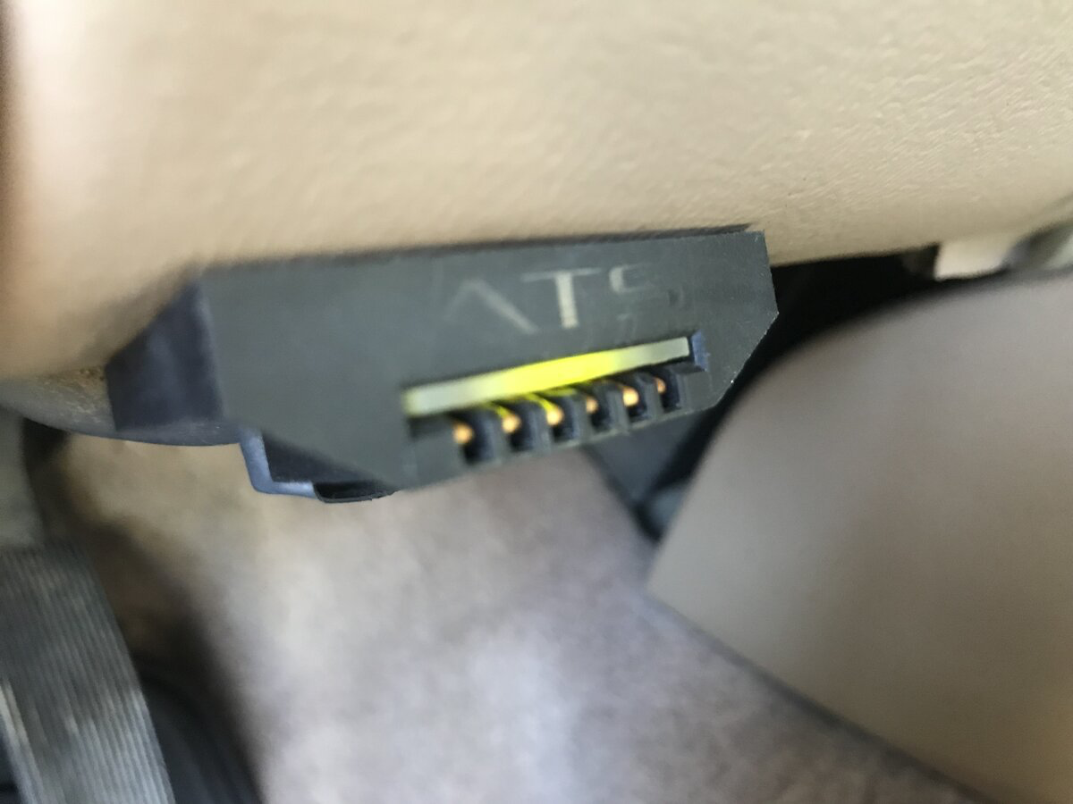

sooo... i saw this port, called ATS in an X i saw. owner said its for an alarm, but why would an alarm have a port?! i know its getting constant power, its lit up. didnt seem like it went to engine bay, didnt see nothin but an inline fuse when i followed the wiring, just went into a loom and i lost it there... anyone got a clue what this is for?
Image search yandex turned up nothing. Aftermarket alarm plug in? Or remote starter? Paperwork I got with my Ex indicated someone installed a remote starter on mine, have yet to find any evidence of it. (Prob took it off again?)

that looks like a dealer installed chip thingy, all the old trucks used to have these on the lots, I am not sure if it was for tracking or stop them from starting, but back in the 90's they all had that when they were on the dealer lot
At least thats what it looks like to me

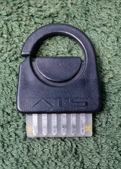

like this
similar to this device
woahhh 😦 alright! interesting, didnt seem like it kept nothin from starting though, she firrdup just fine, didnt insert nothin into the alarm, just go... hmm thisbisngetting more and more interesting!
They de activate them when truck is sold but they leave the cheapo device interface because it’s just a cable and card thingy
At least that’s is my understanding of those things.. all the trucks used to have similar
The fact it starts without the circuit key inserted, it has probably been bypassed. 6 pin would be 3 wires the key breaks contact with. I found a picture of the key on the internet
huh, interesting!!! thanks for finding that! i couldnt even find it online :banghead: time to mark this solved!
