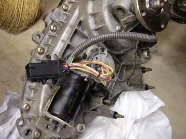

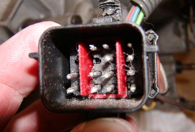

Hello section, do you know how many electrical connections are on a BW4405?
I have a 99 Limited with the 4405, behind a 5R55E. I am trying to find an AWD BW4410, and the differences between these. The 4x4 connections don't concern me, but is there any VSS connector, or something else that I will need connected. Thans for any help,
Don
Here is a pic of the 4405 in my garage. Also, most transfer cases that I know of don't have VSS ports after 1998.

Good, so if I can find a BW4410, most of my concern will be attaching it to the 5R55E, and the front driveshaft. I will call Phoenix Rebuilders next. Thanks,
