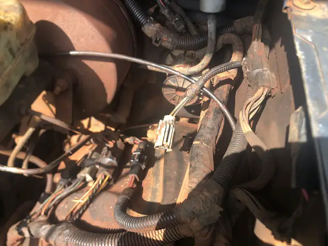

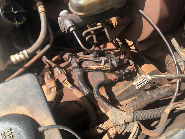

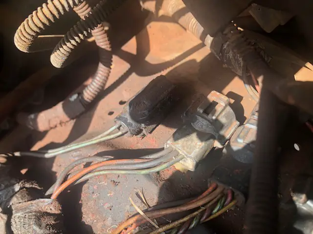

2: While looking around for the PCM (before i realized it was under the dash) I found 3 or so wiring harnesses just hanging around. This had to be something done by the previous owner, but I'm not sure what they do. Pics are posted below (or above idk)

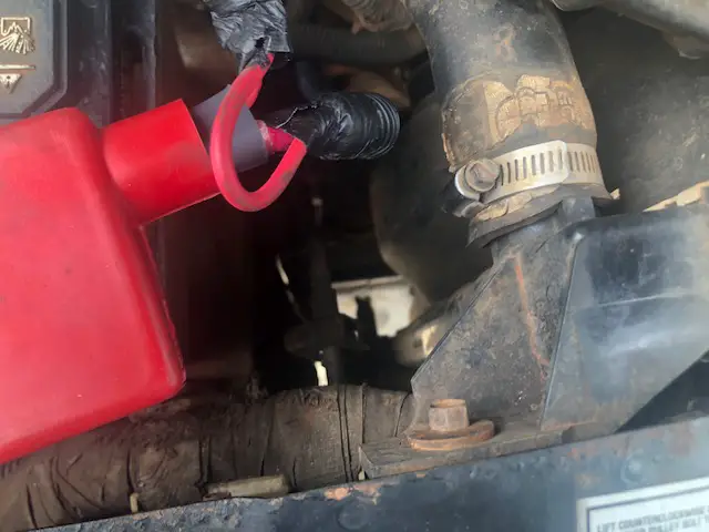

3: I noticed that one of the main air intake hoses ( near the lower radiator hose) is just... broken. Pics posted below.

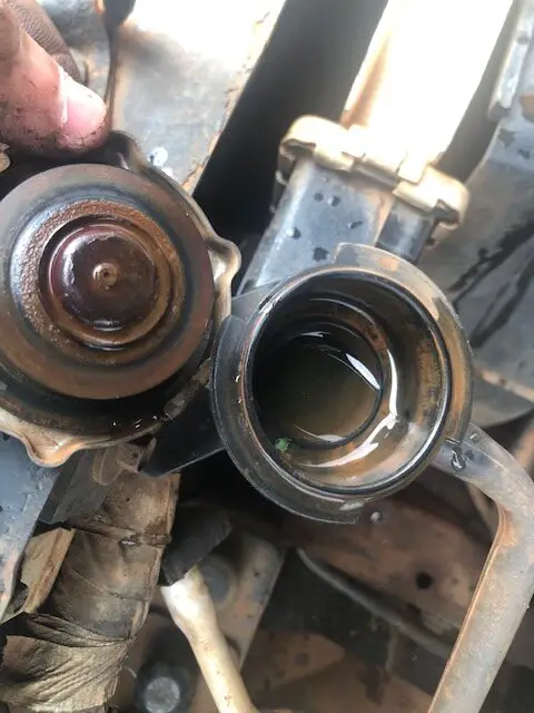

5: I took the radiator cap off and looked inside. Pics are attached. It smells off, and upon closer inspection of what dripped off the radiator cap, it seems to have some sort of dirt or particles in it. The liquid itself does seem to still have somewhat of a green-ish sheen.
That wraps up my update! I hope you all can help me, and know that I'm putting in as much effort to fix this as you all are to help me. Again, thank you so much!
