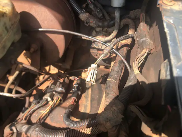

Well actually, i was pointing out the hose shown in the picture... its just completely broken and doesn't connect to anything.
So looking back at the pictures I see the one end disconnected and just laying there. Is the other end connected to anything?
It seems to be connected to some sort of air intake near the grill

The dangling hose that you posted draws hot air from the manifold and heats up air entering the intake until the vehicle gets to operating temp
Oh nice, so since I’m having issues with it running hot anyways, this isn’t really an issue?

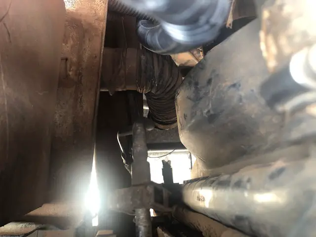

Hey, so as far as that clank goes, i think i may have found the culprit. When the engine starts chugging, it looks like my catalytic converter kinda bounces around. The guy who had this before me must have sawed it off (or taken out) everything past the cat converter, so thats pretty much where my "exhaust pipe" ends. It looks like this:
I think you got it. I have an 01 pathfinder that had a clank and it turned out to be something similar. Fortunately its exhaust had a angled metal post welded to it that anchors the exhaust in a rubber bushing. The post was not in the bushing (cause the excess vibration and noise) but forced it in with a bit of muscle. In your circumstance I would get on of those exhaust hangers with the rubber strap and find a good place on the frame to mount it.

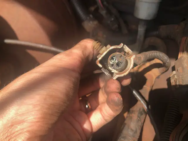

Hi all, I've been trying to use this ex as a learning experience for myself, as well as to eventually use as my daily driver. Obviously, for that to be the case, it needs to be running perfectly, and i shouldn't have to worry about it being a danger to myself or others. However, with this particular issue, I'm stumped.
The ole' rough idle. Ah yes, the very bane of my existence. Starts up rough when warm, idles rough no matter what i do, and (sometimes) will stall at stoplights, or long periods of idle.
What have I done to fix it? Well, i've replaced the positive battery cable, checked for vacuum leaks, cleaned the maf, replaced the ects, replaced sparkplugs and wires, cleaned the throttle body, checked the large intake tube (plastic) for cracks, checked each vacuum line on the tree for leaks (done by plugging them simultaneously, this provided no change to the idle), and checked the iac (I unplugged it, and the engine slowly died).
At this point, the only things I HAVEN'T done, are replacing the MAF, replacing the pcv valve, replacing IAC (though it seems to be working fine), or anything relating to fuel.
Fortunately, it's annoyed me enough at this point to document it, so here's a video of a (warm) start.
Note, the oil guage ALWAYS reads high, and always "flickers" like that. When the idle is getting rough, the voltage meter also does this (because its about to stall).
Main points to take away here are the surging and rough idle. If anyone else notices anything that is ALSO an issue, or has any questions, please let me know.
Thanks in advance, and have a great day!

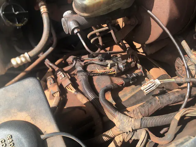

2: While looking around for the PCM (before i realized it was under the dash) I found 3 or so wiring harnesses just hanging around. This had to be something done by the previous owner, but I'm not sure what they do. Pics are posted below (or above idk)
3: I noticed that one of the main air intake hoses ( near the lower radiator hose) is just... broken. Pics posted below.

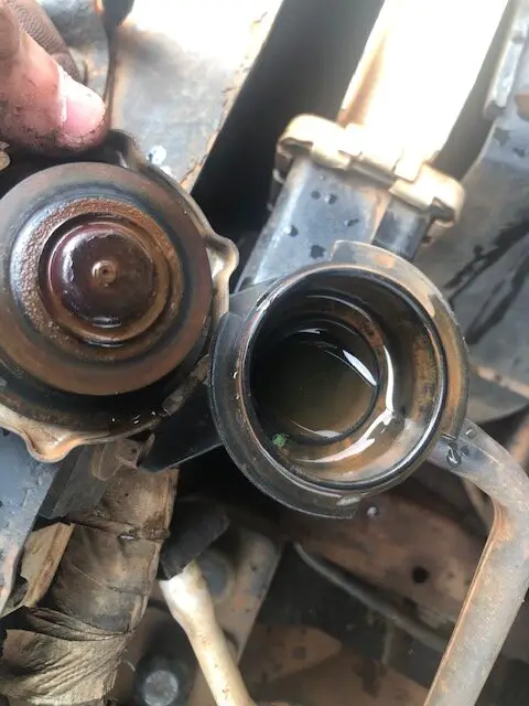

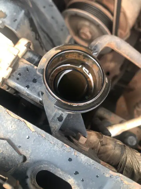

5: I took the radiator cap off and looked inside. Pics are attached. It smells off, and upon closer inspection of what dripped off the radiator cap, it seems to have some sort of dirt or particles in it. The liquid itself does seem to still have somewhat of a green-ish sheen.
That wraps up my update! I hope you all can help me, and know that I'm putting in as much effort to fix this as you all are to help me. Again, thank you so much!
that stuff you are seeing in the radiator looks like bars stop leak , i would do a flush , and more than likely you will have to change the thermostat
