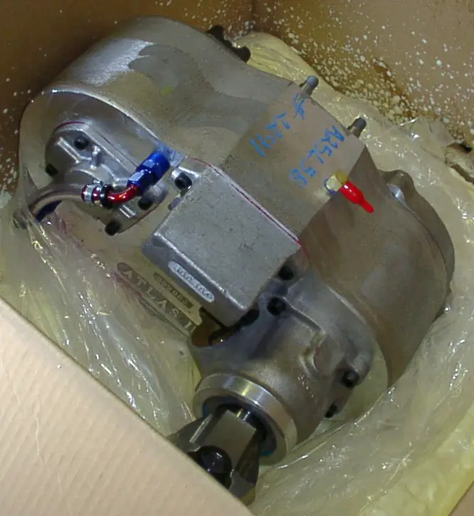

Well after finally giving them 3 different credit cards to work with :fire: they managed to pull enough money out and ship it out today. :bounce: :bounce:
I'll plan to work on it wednesday and thursday evening, order driveshafts friday, and it will be back together in time to test it out before heading up to Moab.

Ahhhh! The wait. . .Its torture. :banghead: I can't sleep, can't concentrate. . .I think I've read the online install manuals a half dozen times. . . :rolleyes:
I just want it to be done with. . .

From advance adapters the 3.8:1 runs right at 2k (the 4.3:1 is more like 2.4k). Add to that the shift linkage and any custom output yokes you might want, and $hipping. . (a grand total of ~$2400 for me)
And yes the only other major thing would be new/modified driveshafts front and rear.

Alright, Now I'm Mad. :fire: My Atlas is still sitting on the shipping dock at Advance Adaptors. So much for trying to get it in before Moab.
Now, if you will excuse me, I'm gonna go find someone to :shoot:

Woo Hoo! :bounce: :bounce: :bounce: It's here!
I'm going to make a desperate attempt to get some driveshafts made for me in time, so its still up in the air as to whether it will be in for Moab or not. This Monday being a holiday is just screwing everything up :fire:

If anyone is still reading this:
Its officially off till after Moab. AA seems to have done their best to screw the outputs up. (hmm. . I seem to have heard this before) :banghead:
The rear is set up for a CV while the front is a U-joint. It should be the other way around (at least for my application)
Oh well. . .at least all the pressure is off to get it running before Moab.

They did the same thing to me, but I got a local shop to change it around and then I got rid of the CV and used a regular yoke with a double cardon joint.

by CV, I'm referring to a double cardan joint. . and not the true CV joint of the stock shaft

It's In!
Piece of Cake
(OK, so I can't shift it yet ;) . . . but that's tommorrow night :D )

just wondering, how many t-case to tail shaft bolts does the '95+ have and how many splines is the output shaft, I really hope they make a Atlas 2 for the v8 Ex trans, if not I'm going to have a really bad time trying to find a t-case for my swap...

The 5R55E, 4R55E, and A4LD are all similar: 5 bolt, 25 spline output (w/ the 4x4 tailshaft anyway)

The Atlas II is the t-case anyone would dream about (and I have been :D ): low ratio (3.8 or 4.2), independant shifting front and rear allowing a number of combinations (i.e. 2Lo rear, 2Lo front, 4Lo. . .), and bullet proof.
And my excuse for upgrading is that my stock 44-05 died a long horrible death (something to do with running Golden Spike when I already knew it was on its way out :) ).

Ok, so I get all the shift linkage set up, and pop her into Lo and :eek: Holy Crap thats low! :D :bounce:
