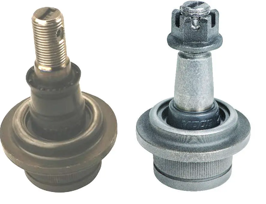

If the lower BJ, I assume it is the old style typical looking boot design (two generations ago, see below both newer generations), not the newer design lower BJ with the recessed/integrated/low-profile/whatever boot? AFAIK the newer style boot can't be replaced, but maybe that was just an assumption on my part, or maybe I don't remember them well enough and an old style boot could still be put on over, a shot new style boot?
Hmm, just noticed that it looks like Moog "might" have redesigned the lower BJ boot
again. Pic on rock auto now (left side) vs pic of what I bought 4-5 years ago (right side) from Rock Auto, both part # K8695T:
