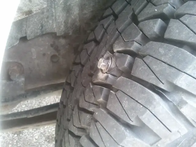

That's a bummer about the tire, I hope it can be repaired. I've had one that couldn't be fixed due to the size of the rock I found in it. Good luck,
I had a tire I was told couldn't be repaired. It had a 1 1/2 inch cut in the tread face. Took it to another tire shop, they popped the tire off and patched it on the inside, never leaked again. Those damn BFGs sucked, always had flats. I'd imagine they could patch yours, but if they say no, get a second opinion. If its small you could get one of those plug kits, i've done my own several times before.

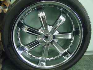

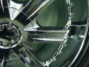

Guys just for ***** and giggles would 22" rims on 265/35r22's fit?
I this rim is BEATIFUL! And they say LIMITED on the spokes :)
(Not getting them unless he would work out some kind of payment plan but I figured id see if they fit. They came off an 05 AWD Explorer)
These are seriously my dream rims, I hate crazy looking ones with tons of details and random spokes. I love 5-6 spoke rims like this.
Umm, I don't believe that's likely.

Anyways, Firestone wants 19.99$ to patch my tire for me and they're open today after I get off work, thank god.
That blot in the tire isn't too big, one plug may do it. Only if two plugs cannot seal a leak is it really too big of a hole to fix. The rock i had in mine was very large, and the tire leaked with two plugs in it. That tire was about 3/4 gone anyway, so I change the tire.

They patched it just fine! I was worried, thinking the bolt was alot bigger than it really was.
I took it to Sears, 19$ they plug AND patch it (Supposedly)
Aren't those 7 spoke rims or is one of the spokes considered a thumb? :)
They are....I didn't even count :p:
