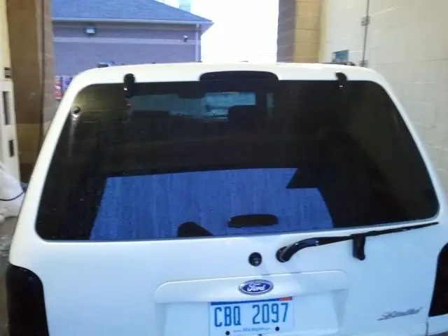

Thanks Brian, and I bought the hatch with the whole hatch harness. I found out later that it's a three wire wiper(95-01 is four wired), and controlled by the GEM module. So it isn't known yet the best way to operate it.
The old 1st gen wipers were three wired, but they had separate modules for it, and a different control/switch. I don't want the old 1st gen control, I want the stock wiper switch to control it. That means doing something special with the control wiring, possibly buying an 03+ GEM and mounting it in back, and more modifications.

But the glass will just swap over with the wiper in it? I would love that! I would REALLY prefer the stock switch also, but if it requires me adding a rocker switch or something, im up for it.
I bet 1/4 wires in ours are to make it stay up on the window, (When its on), and since the new style is already on the window, it wouldnt need it...
Wow, these ones dont even have the metal studs...AMAZING!
I just wanted to see them next to each other, everything seems to line up right and curves seem the same. Where do the struts mount? And we'd have to fab up a squirter by the 3rd brake light since ours are built into the wiper, and those ones arent.

You wouldn't have to fab a squinter on. You have to swap the whole hatch, not just the glass. If you just swapped the glass you would still have the wiper arm on the old hatch, or a hole if you removed it so it would require body work to fill.
I was planning on shaving it if the glass swapped...not many clean 01-03 sports around in the JY's

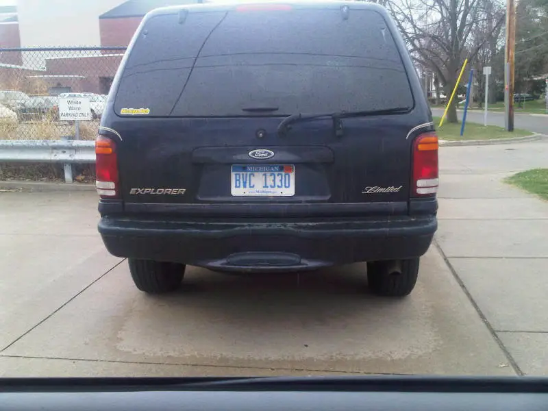

I saw this cool setup at lunch today-
Oops sorry- wrong wiper. That was just a non-rusty Limited bumper... :D

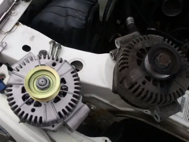

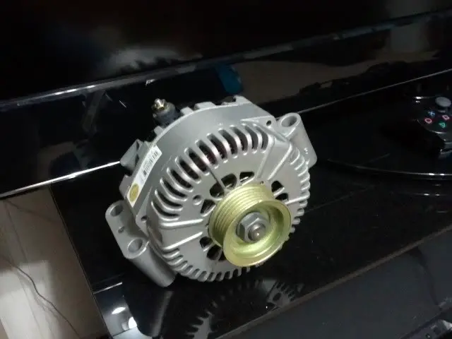

Fun day today, fried my alt (As you may have seen my 911 thread)
Got a new one, gotta put it in tomorrow morning cus I have to be on the road by 1130

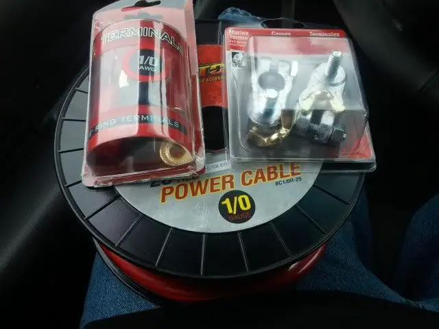

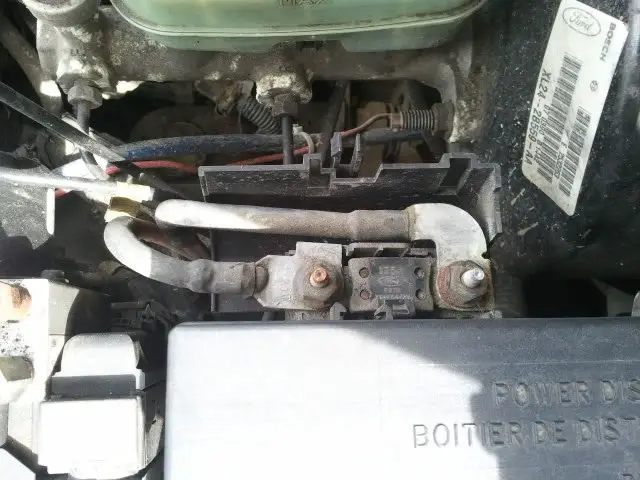

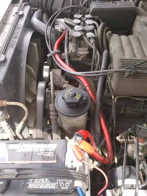

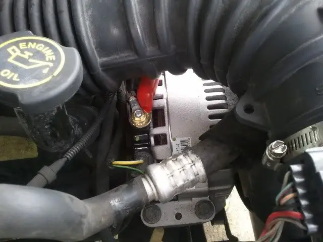

Also got my wire, new terminals, and the ends for the 0 today

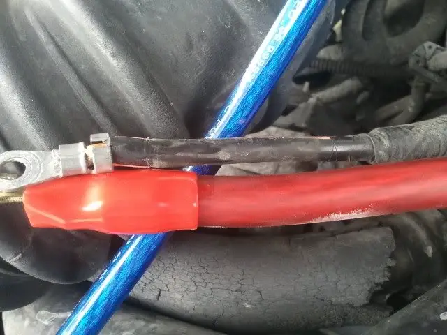

I cant believe how thin the alternator wire is!
Shes pretty:)

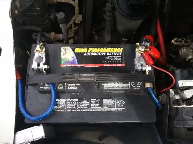

Havent ran my amp wire, or to the fusebox or alt to ground yet, but I got the main's done
Which wire would I run it to? The first one im assuming?

The old alternator sounded like the bearings were about to go in the pulley, it was definitely on its way out. I had them test it at AZ out of curiosity and it failed all 3 tests :)
I wish it would have just slowly went so I could have ordered a HO alt, but I can always sell this one I guess.
Im gettin good at getting the belt off now, I still hate it though :D
On the Power Distribution Box, one terminal is from the alternator, and the bar in between is a fuse. Make sure that your main wiring includes a protection like that fuse bar or another installed fuse.
You don't need any new ground wire for the alternator, it's grounded through the engine. Add new grounds from the body to the amps, and from the body up front to the battery.

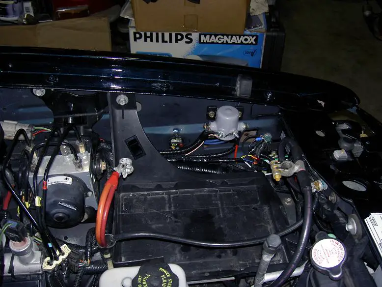

I added some when I added small circuits and potentially a 30 amp compressor. I used 8 gauge wire along the stock alternator wire, and the old battery ground wire was cut so I routed that from the frame near the starter, to the radiator support next to the battery. See that main ground point ahead of the battery?
Nice...very clean engine bay I must also say:thumbsup:
Thanks, that was before ever driving it.
The whole body was off, and I painted the front clip inside and out, back past the repair(front seat). There was rust in that pocket there from the battery.
