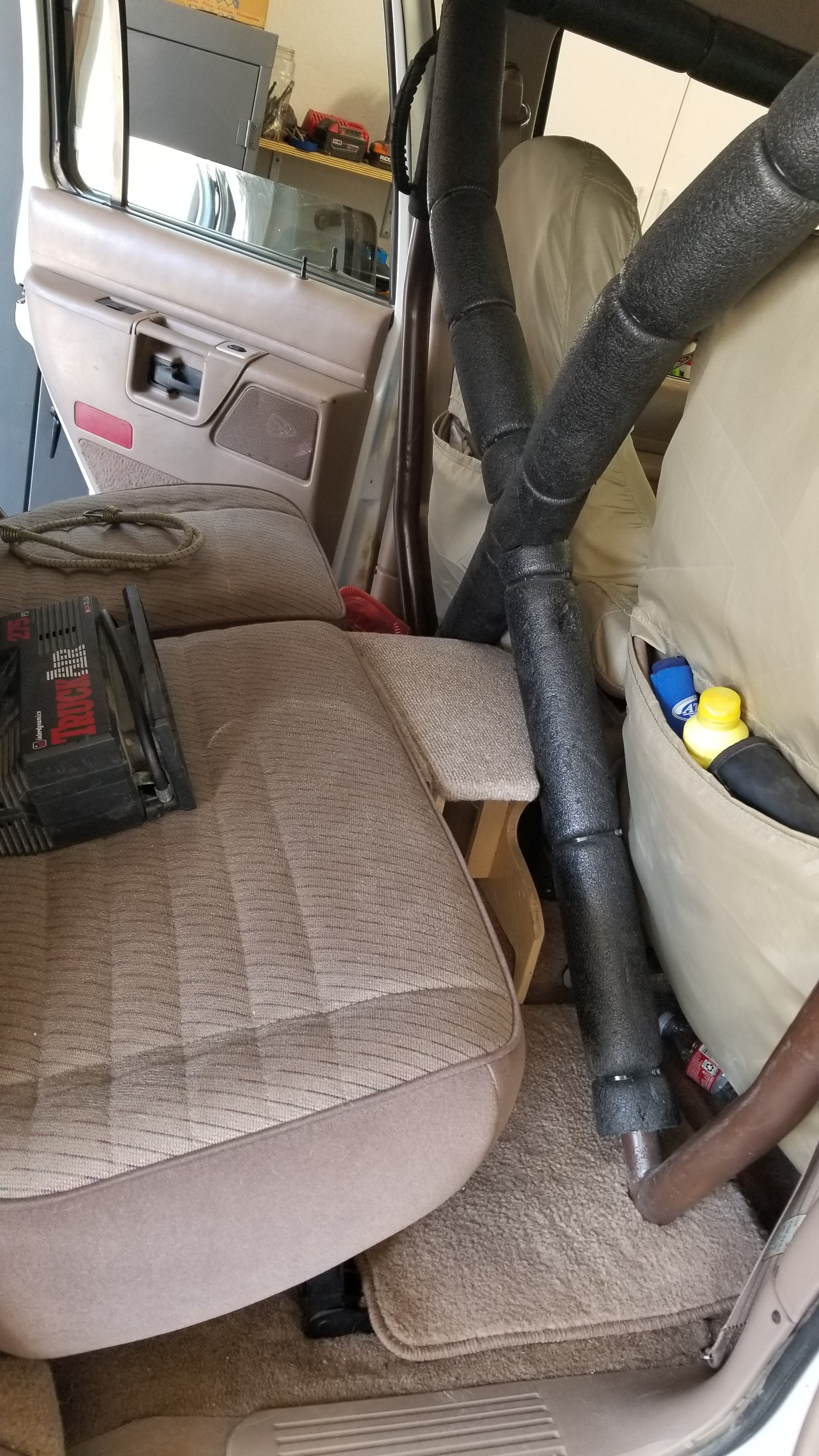

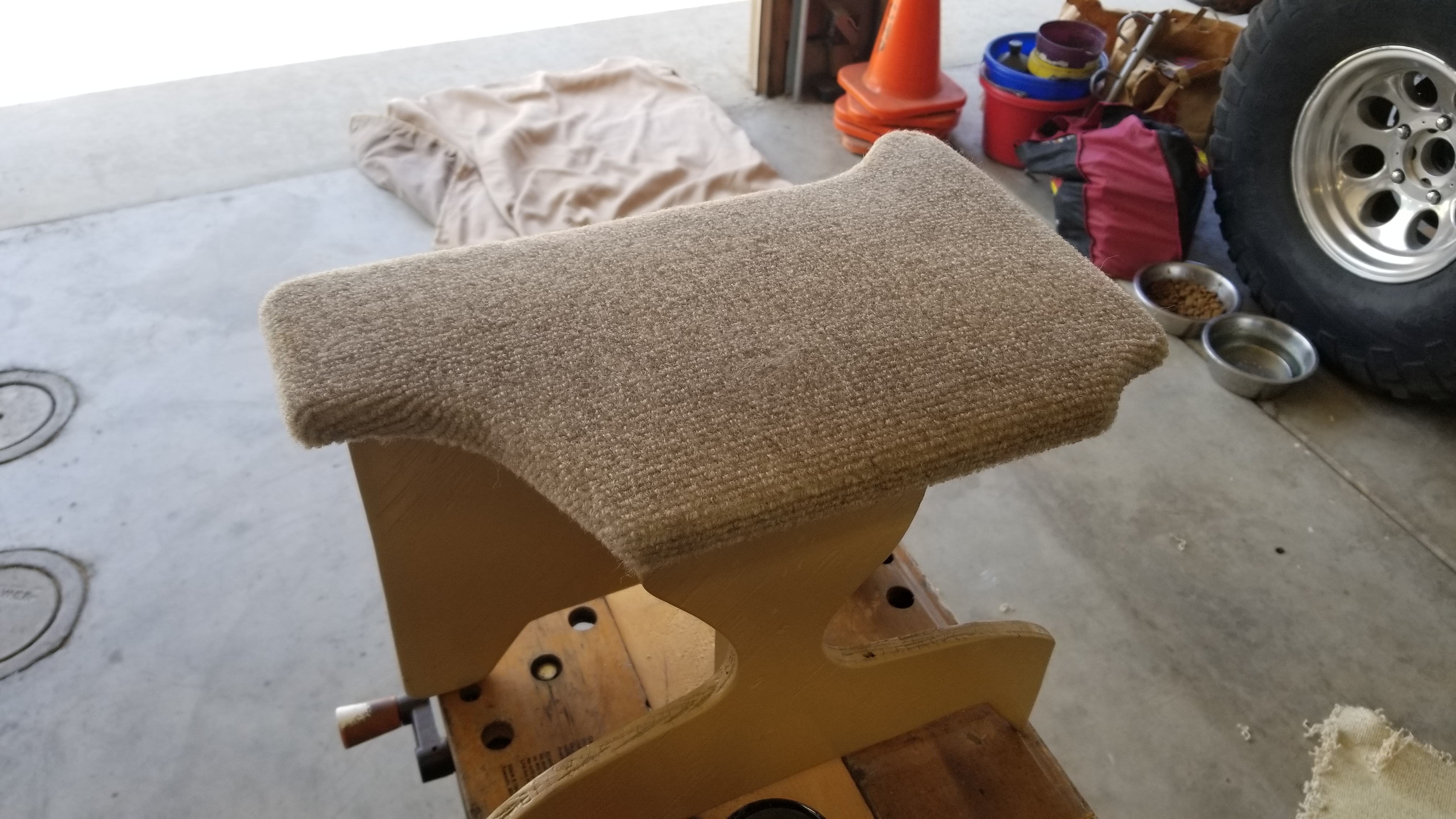

Yesterday, I was looking at my nice and clean Explorer and did not like the carpet covered dog rest in front of the back seat. Its so Sasha the Wonder Dog can rest her head through the cross support for the cage B pillar, and helps her fit with people in the back seat. It did not match the décor. I covered it with the same carpet material as the cargo area shelf project over two layers of batting. Much better. I might replace the batting with foam that wraps around the edges to help it lock into place, but then would have to purchase another piece of carpet as I used the last bit on this. I think its fine for now.
I also rearranged items stored under the back seat so I can easily fold down the 40 side of the 60/40 seat and access the hidden storage, which I figured out will nicely fit two AR type rifles in tacticool cases.
