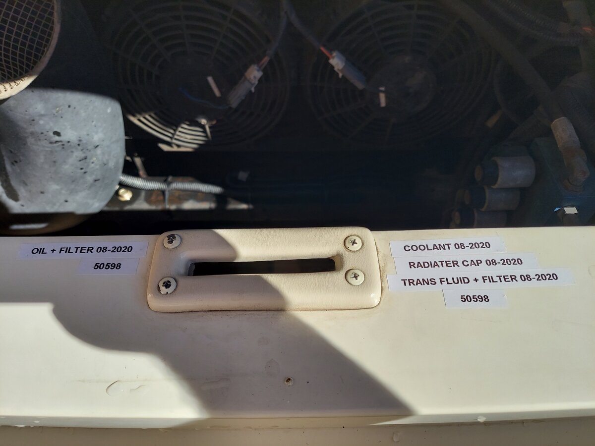

Sucker holds over 6 gallons of coolant. The radiator cap is fairly easy to get too on this coach, but the drain plug is hidden by a cross member and there are two drains on the engine that need to come out as well. Over half the coolant was in the engine. Engine holds about 7 quarts of oil. Allison trans holds about 5 gallons. You get about half on a fluid / filter change with only changing the external filter. Internal filter isn't supposed to be changed unless rebuilding. While draining it I almost stopped and put the plug back in it was coming out so clean. Need to use a transfer pump to get the trans fluid into the dip stick tube. I bought two of the HF hand pump $6.99 versions and threw it away when done. Tossed the other one in the coach's storage. Allison recommends their 295 fluid, but its $55 a gallon. The transmission guys say to just use Dextron VI because with a RV you never hit the fluid change interval of 250,000 miles. I found out reading data sheets and interweb searching that Vavoline Max Life synthetic trans fluid is compatible with 295, but they didn't pay Allison to approve it so its not on the list. I used that for less than half the price of the 295. I have been using the Max Life trans fluid in the Explorer and the Silverado for years with no issues. A few weeks ago I changed the spark plugs and wires. RockAuto had Bosch Platinum IR Fusion plugs for $1.88 each on wholesale closeout. AutoZone price is $7.50 each.
At least there is a lot of room under there to crawl around. 5 gallon buckets stand up under there without putting the leveling jacks down. Its getting hard to find parts for the Workhorse W22 chassis, but this thing pulls and drives so good, and its in such great shape inside and out, I have no interest in another coach. I found that for drivetrain parts, I can usually do a search for a GM 2500 HD 8.1l truck and find what I need. Its usually cheaper than for the Workhorse, but the same parts. I had the turn signal, cruise, wiper, hazard, everything else multi-switch fail last year. I found one on-line for the Workhorse and it was $250.00. I figured there was no way they designed and build one just for the Workhorse so I started comparing it to the generic one GM installed in a bunch of model vehicles for about ten years. It sure looked the same so I ordered a aftermarket one for $25.00. Exact same part. Today, when I removed the radiator cap I noticed the rubber was failing. A Workhorse cap was $35.00+shipping. I cross referenced the Stant part number and its the same cap GM used from 1972 to mid-2000's on just about every vehicle that takes a 15 pound cap. It was $6.99 with free shipping.
