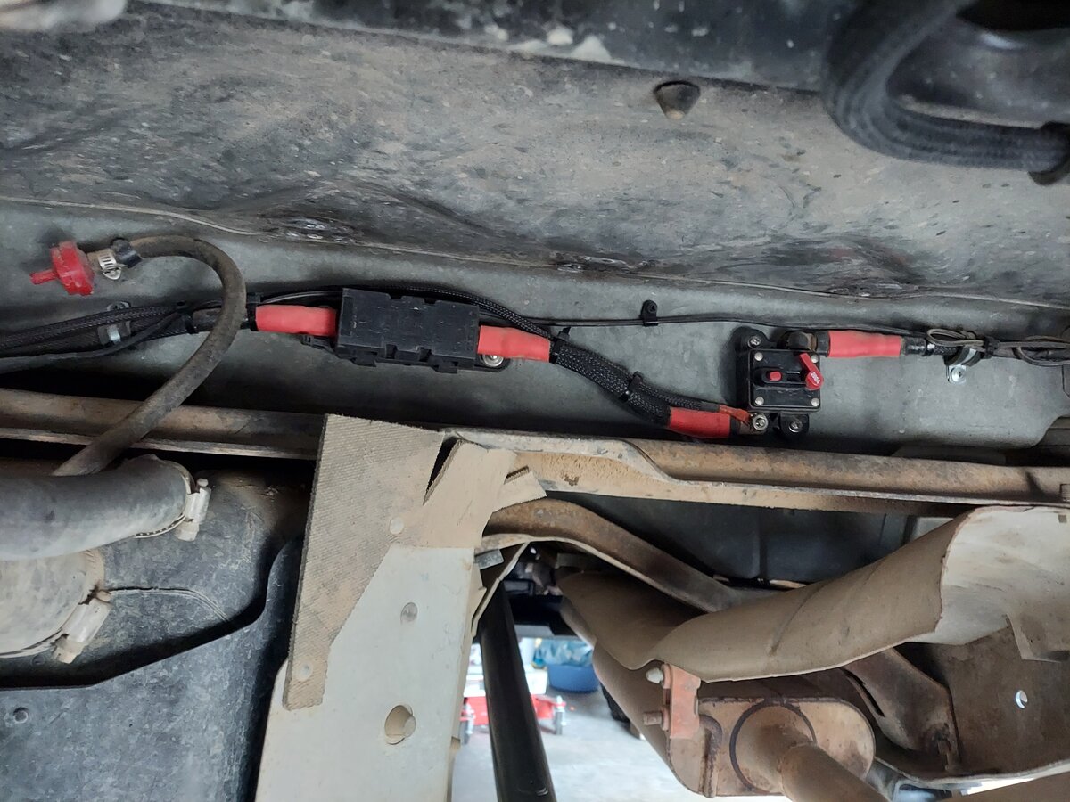

While waiting for the new auxiliary battery to arrive, I decided to rewire the main cable and the cable that feeds the amp. I wanted the 200 amp breaker to be closer to the battery, its about 2' of cable away currently but in a very safe and accessible spot. The breaker is mounted to the flat space on the body where it steps up for the cargo area, above and behind the axle. I can get under there in a few seconds and push the breaker if it doesn't pop on its own. After messing around with everything I figured out that its already in the best spot. I also want the amp power cable to be be on the cable side of that breaker so I am rewiring so everything can be disconnected at the breaker. The only accessory I will have mounted directly to the battery is the air compressor, but it has its own plug and breaker.

I got the amp cable rerouted after taking several work breaks. I wrapped the cable in two layers of flexible loom, as is my custom with power wires. Here is picture of the breaker before I ran the amp cable to it, and next to it is a 400 amp mega fuse. There is another matching breaker at the other end of the auxiliary battery cable. Now I just need to wait for the battery to show up. The 10 gauge wire already attached to the breaker is for a auxiliary fuse box in the rear cargo area. The cable amp attached to the same post, on the off side of the breaker. That thinner wire running past is for my LED rock lights. The breaker and mega fuse holder are secured with well nuts.

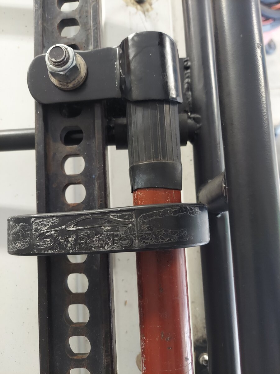

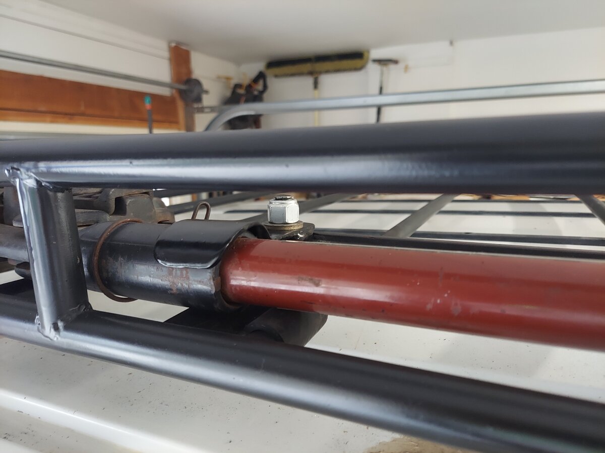

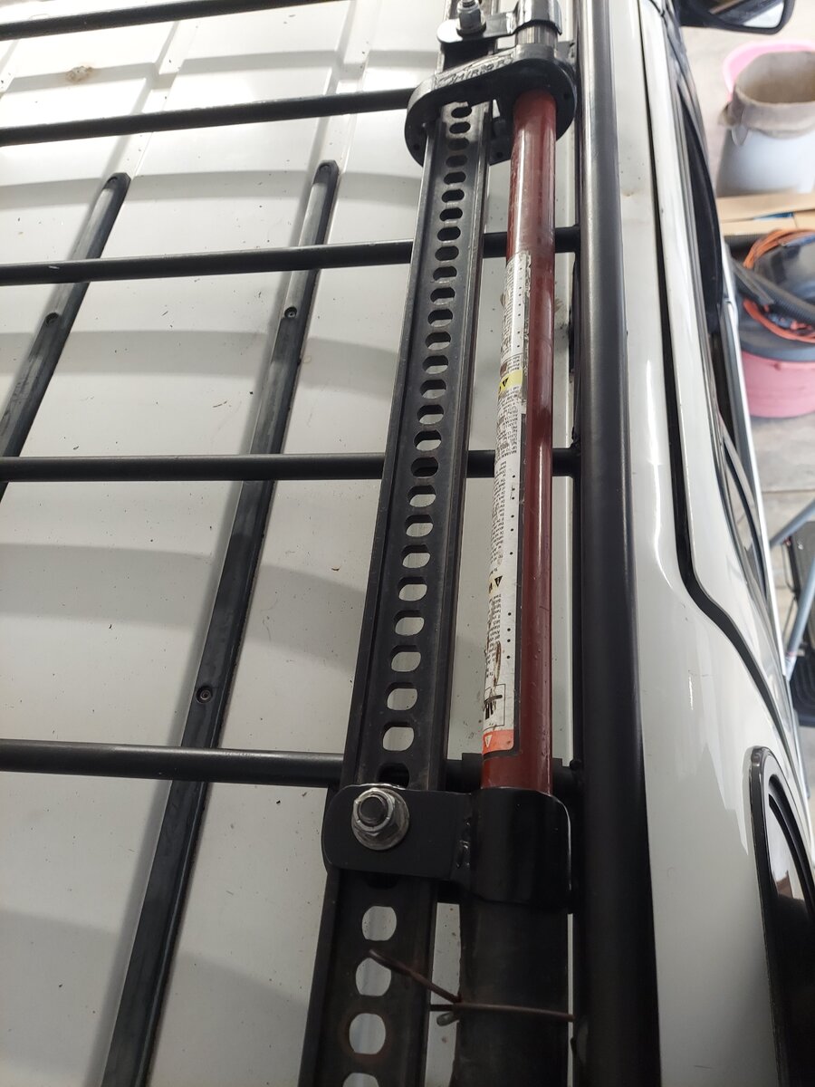

I did a small modification, but it did take all day. But that's just because I kept changing my mind. My Hi-lift jack is mounted laying down on the roof rack. I actually decided on the rack height based upon the jack fitting inside of it when mounted. I have always used zip-ties to keep the jack handle from rattling. I hardly every use it, and its usually for someone else when I do, but its a pain to have to bust off the ties and then replace them every time. I ordered one of those polyurethane keeper/isolators. It arrived a few days ago, and it was so loose I could move the handle 3-4" side to side, so it was worse than the zip-tie method. After initiating a return request for the crappy isolator, I looked at the jack mounts for a while, then looked at them again. I decided I could fab up keeper/isolator jack and handle mounts to fit my existing mounts so I would not have to redo everything and this is what I ended up with:
Yes, the spacers are made from discarded Harbor Freight angle grinder arbors, so once again I have reinforced my "never throw away anything if it looks like I might use it for something in the future policy". The spacers fit inside the edges of the jack bar, securing it to the mount. Only a small amount of tension presses the tabs against the jack handle, which presses the jack handle against the roof rack cross bars, keeping it locked in place and unable to rattle. I have little rubber bumpers around the cross bars, made from some rubber tubing I had here at the house. The keepers use the same 1/2" bolts and nuts I already have in place for the mounts. I will post another picture after the paint is dry, probably tomorrow.

The seller of that keeper / isolator I ordered offered me 30% off to keep it, so I figured it might help to keep the handle in place when getting the jack down. I have had it open up while handing it down to someone so it will at least keep that from happening. The holes in the hold downs are oversized so I can remove and install them with no binding to speed things up while out on the trail.
No wiggle at all
The hold downs are offset to the bolts on purpose to get more contact with the handle since the bolts are slightly ahead of where they would be optimally, and I didn't want to pull the roof rack and completely redo the mounts. The jack was difficult to place on the bolts the way it was before so I ended up slotting the front mount bolt hole to move the bolt forward about 1/8". I couldn't remove the bolt to enlarge the hole because its too long to remove without removing the rack. The roof rack is held in with well nuts and also sealed around the feet to make sure no moisture gets in there, and its working so I don't want to mess with it.

My rubber keeper thingy is tight, no slop like yours. It is made by Hi-Lift. It is so tight that it's a bear to remove. Between that thing, and the metal wire keeper, there is no movement on the Hi-Lift handle at all. The base is where the noise comes from, and I use a bungee to fix that BS. lol

The Hi-Life base is pushed up against one of the cross bars of the roof rack so it doesn't rattle.
