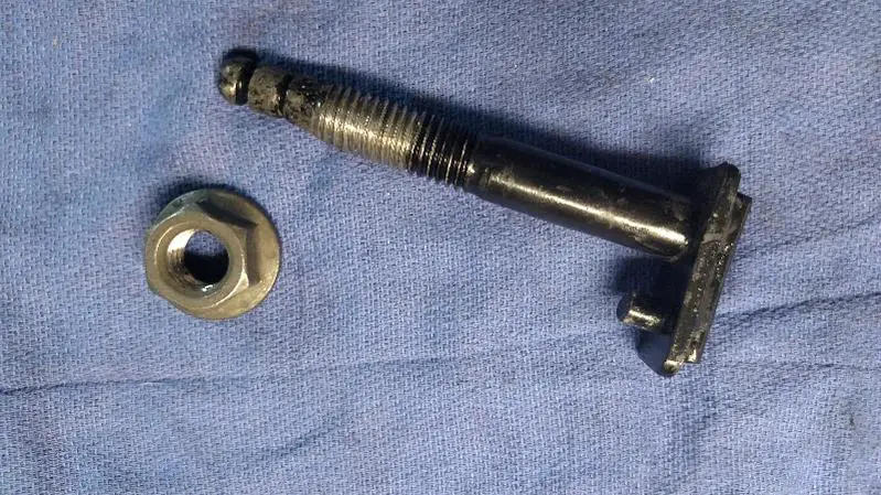

So I used the part that goes inside of the receiver and ran a bolt through it, but that broke too (the funny spring loaded square bolt, not the main bolt).

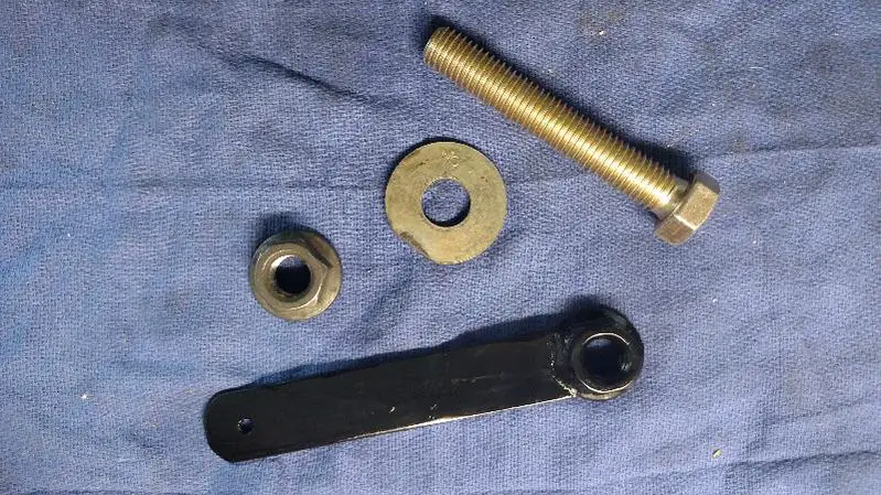

So then I made this J hook pin.
It works by the short end going into an added hole I drilled into the side of the receiver, putting side pressure on the mount. I decided before even using it that it would not last, but those two pins together gave me this idea. Ladies and Germs....I give you....
Only works with hollow receiver mounts. The tabbed flange locking nut I made up goes inside the receiver. The fully threaded bolt goes in the pin hole and threads onto the nut, pulling the mount tight against the receiver on one side. Then, the other nut goes on the end protruding from the pin hole, snugged down. I still need to cut the locking flange off the J pin and weld it to the end of the bolt, so should have that done by tomorrow. I know the odds of someone walking by with a 15/16 wrench in their hand to steal the tow bar are in my favor, and a locking pin is probably not necessary, but we leave the RV parked for hours in isolated places so I want to make it too hard to bother with trying to steal. And they do get stolen, that tow bar cost $1200.

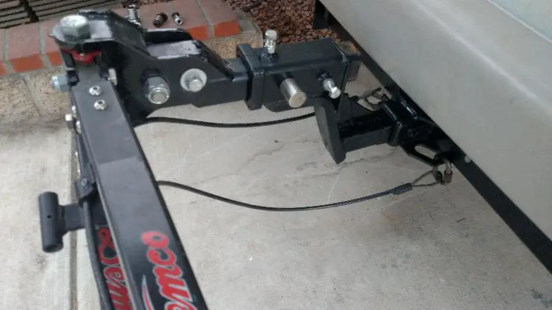

This is why it comes loose and rattles. I need this extension to raise the tow bar so it is even with the mounts on the Explorer.
Adds lots of leverage. The tow bar fits tightly into the upper receiver, and as you see, I added two set bolts, one top and one side. It doesn't move. The RV hitch does, even with the added set bolt I added (broke a 3/8 bolt off coming or going to Truckhaven). So the new pin dealio, and a added 7/16 grade 8 set bolt as far back as possible on the bottom.

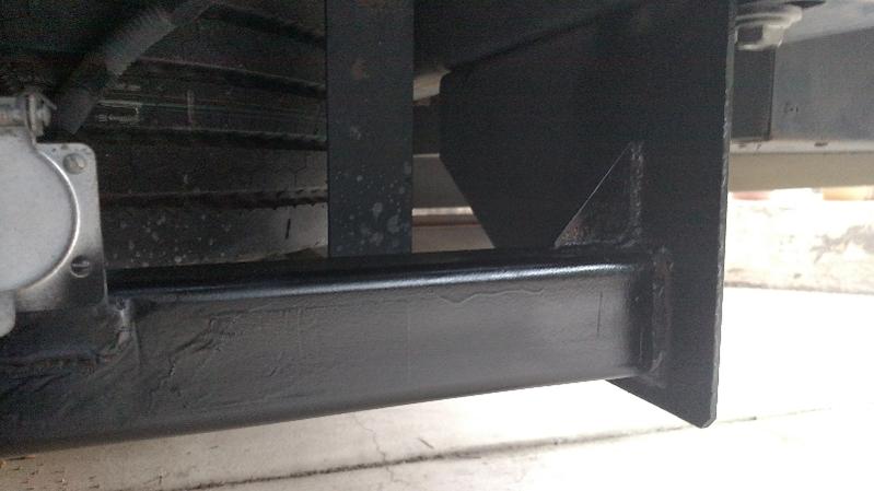

I also added a gusset to the back of the extension, and two to the RV hitch.
The real fix would be to lift the motorhome so it matches the explorer :D Hope it works for you.
Its already over 12' tall. Could you imagine what a wild ride that would be, swaying down the highway, ready to tip over at the slightest breeze..:eek:
