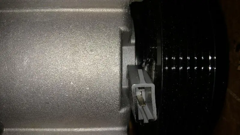

Got an entire AC kit off ebay to give it one more try. Compressor field coil is pressed on in wrong orientation so the electrical plug is crushed. Working with the vendor to see what he wants to do.

The AC compressor vendor is sending me a new unit and said I could keep the old one if I sent him a picture. Sent these:
