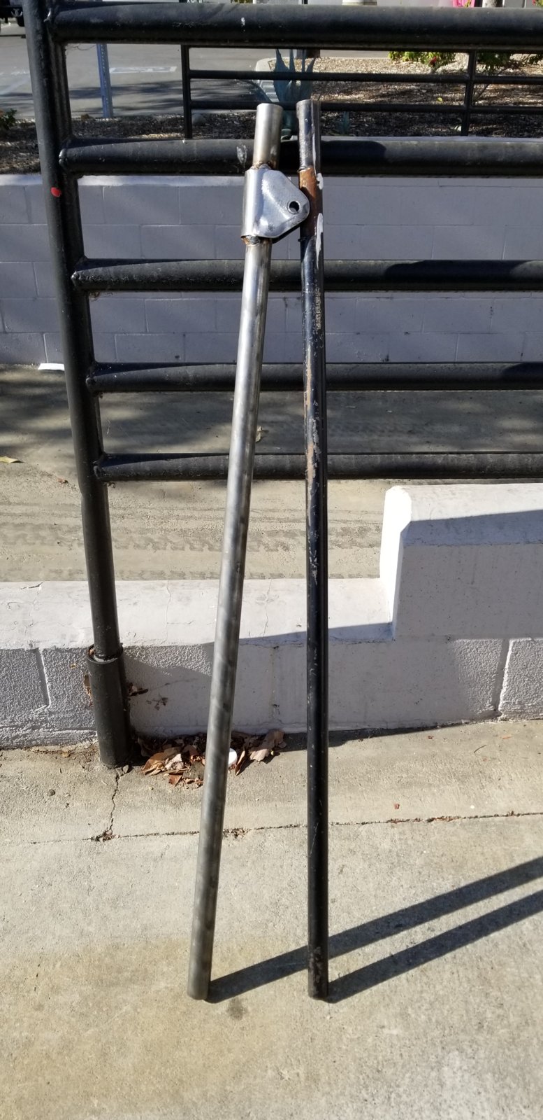

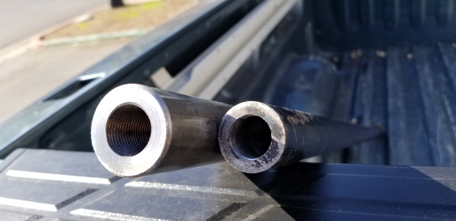

My buddy Ken finished the tie rod. Its 1.25" OD, 0.5" wall DOM (= 0.25" ID). He drilled out the ends so he could thread them for the 3/4"x16TPI rod ends. It weighs at least twice as much as the old tie rod. Should hold up much better and I don't have to redesign my entire steering as it should just bolt right up. Cost me some gas money, and he gave me another six pack of ale for my trouble.

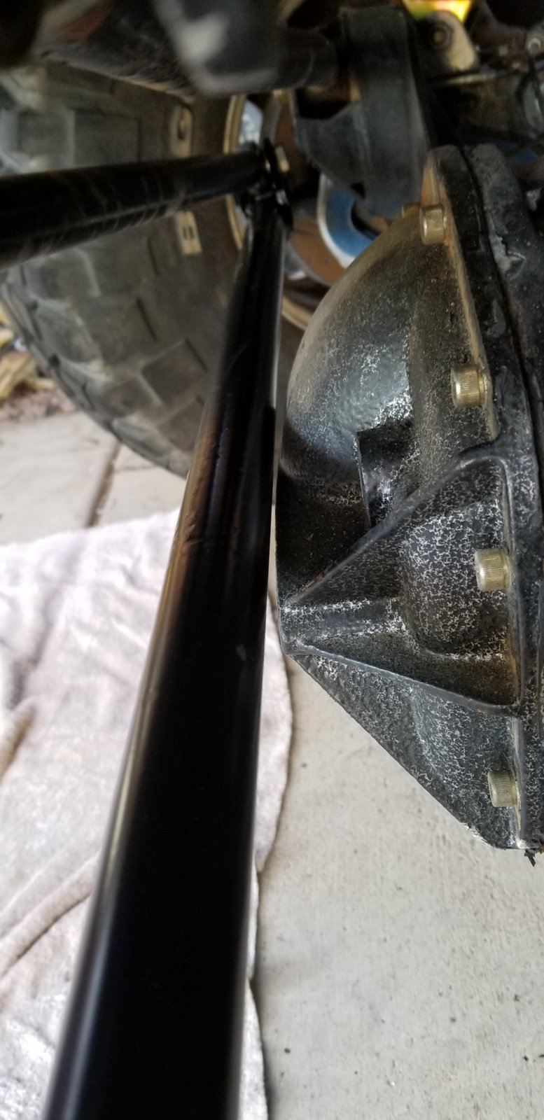

All I have left before I can drive it is the transmission gauges, install the tie rod and set the toe-in of the front tires. Still need to do a bunch of little stuff, get it insured again, and finish up with DMV.

the new tirerod should fair you very well my friend.
My buddy who made it thinks it won't bend, which is not realistic. If the weight of the front axle is sitting on the tie rod, it really doesn't matter how strong it is, its still going to bend. The new one just has a better chance.
My 1.5 x.250 tierod has a slight bow in it. For the amount of times I have rammed it into rocks I am impressed with how strait it has stayed.
yea i have the same size as Matt does, and the last one I took off was really bowed. It was also 8 years old, and you see how it that thing has been used. They last a lot longer, but they still bow. They don't dent though! my old one had a bunch of drag mark gouges from rocks, but no dents.

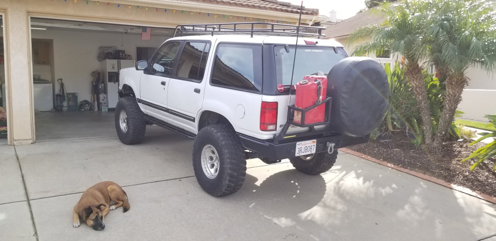

The Explorer is ready to leave the yard. Tomorrow while my wife is at her spin, rhomba, tumba or whatever class it is, I am going to pull it out and give it a bath. Then I am going to take the wife's treadmill and all the boxes she has stacked up in the Explorer's parking spot in the last three months and put it in her parking spot.
Its all cleaned up. Took it for a test drive around the neighborhood, felt like the same old Explorer.
