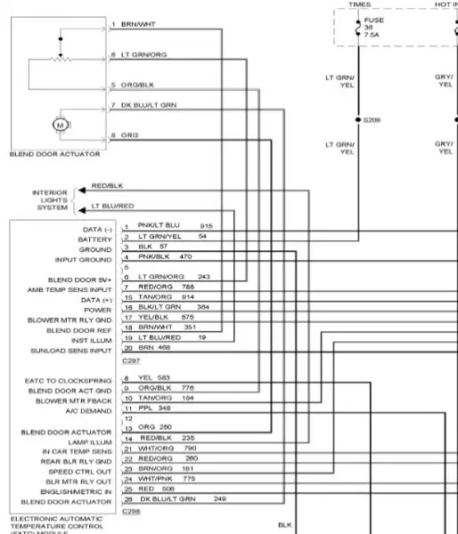

I have a 98 Explorer Eddie Bauer with EATC. I have the suspicion that the blend door actuator is bad. However, it would help if I knew the pin-out of the eight-pin connector. If anyone has that, please post it in your reply.
Free wiring diagrams can be found here in the auto repair referencecenter:
EBSCOhost Login
User ID = s8921298
password = password
This is exactly what I was looking for!!! Thanks a bunch. One more thing... Do you have the vacuum diagram for the same system?

I was able to pop it off the mounting bracket. It just snaps off. I took it apart and found some of the teeth broke off the small gear closest to the motor. I also removed the blend door itself via a very frustrating method. The upper pivot point was split in two where the actuator shaft connects. I bought a new dormandorma from NAPA that has a metal pivot point. I tried for two hours and could not get it in. Had my mechanic install it and a new motorcraft actuator. Problem solved. Everything works great.
