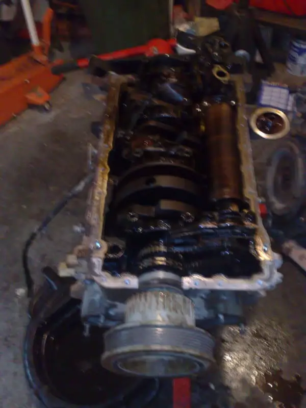

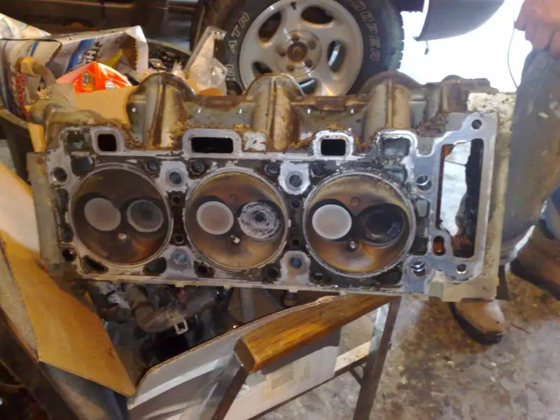

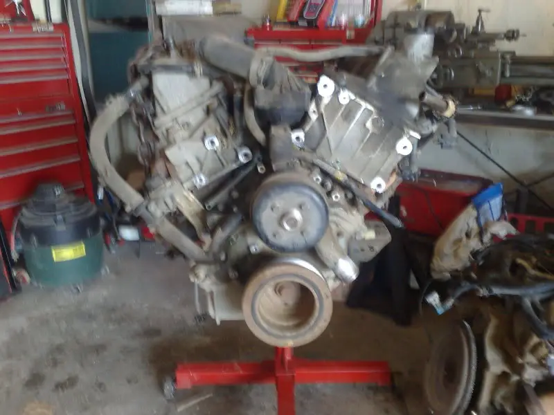

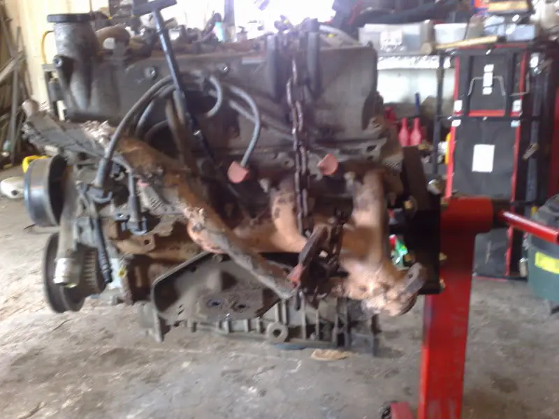

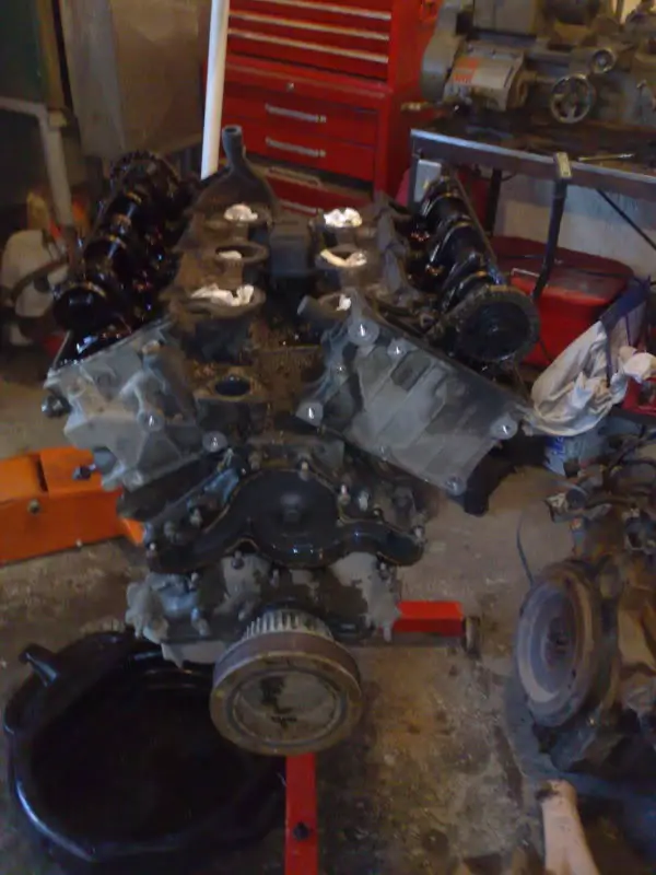

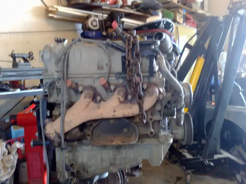

So today, I got the engine on the stand and started the tear down.....
It looked like a mouse had been nesting on top of the engine.. it was a mess... I also knew that at least one chain guide was gone, but I was shocked at the "black clay" inside the engine. Doesn't appear to be much damage inside, but we'll know more as we progress...
Picture time..
Before teardown...
"black clay" from inside driver's side of engine
Bits of broken tensioner
This side of the engine was full of really thick, clay like deposits

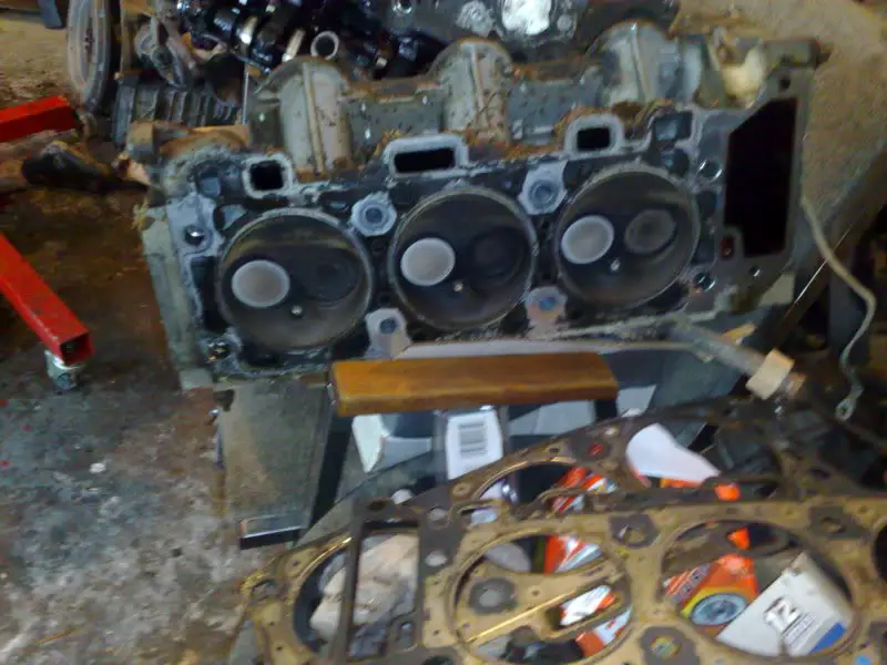

Both heads off

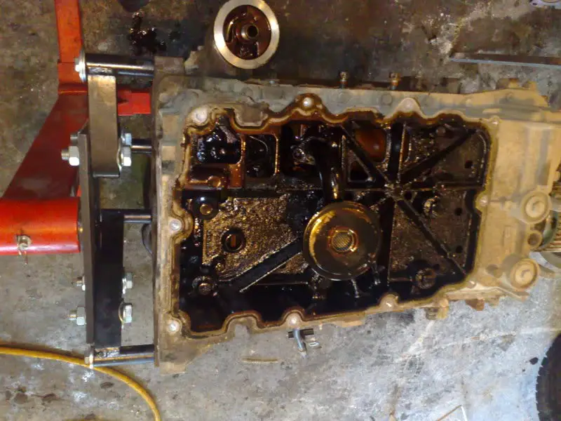

Sump off
Crank
That's all for now

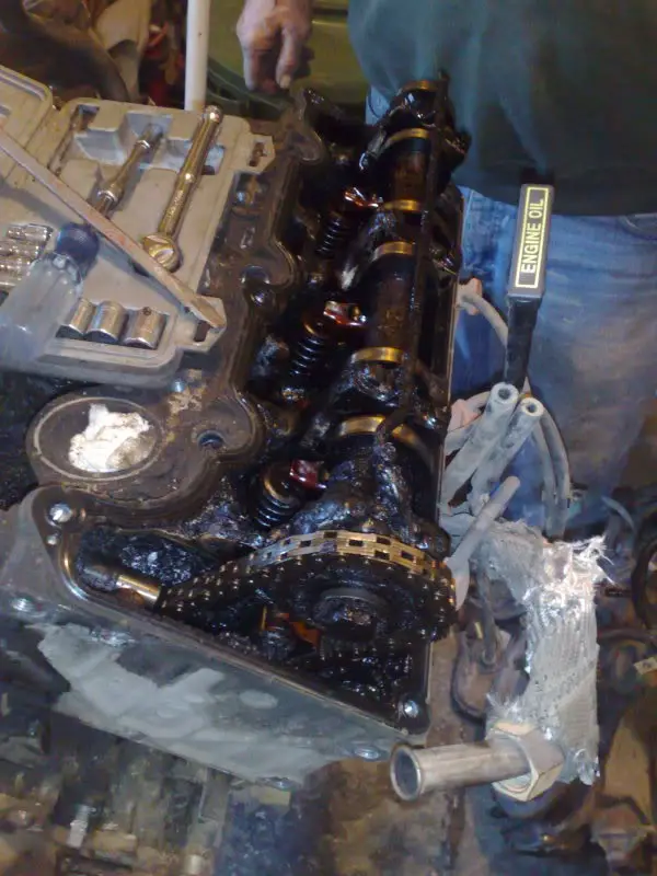

thanks... I managed to get the crank pulley off yesterday... the damage inside was interesting to say the least... one of the metal chain guides had disintegrated and had lodged itself under one of the cogs. This caused one of the bolts to snap off leaving no drive to any of the chains, except the balance shaft chain. I'll post some pictures up in a bit.
Si
So yesterday, I carried on with the stripping down of the engine and I removed the back seats so that I could clear up the power steering fluid spill in the back and the rest of the broken glass.
Rear seats removed
Snapped bolt that caused all the trouble in the first place
The pulley at the bottom of the picture is where the bolt came from
With the outer cog removed, you can see the bolt snapped in the roller. The chain was also wedged between the engine wall and the piece of debris that is caught in the cog.
This piece was lodged in the cog, which caused the chain to seize, snapping the bolt and causing the engine failure. On the plus side, it looks like no damage to any of the valves and there's no wear on the pistons either.
Si
Some of those valves dont look so good. Are the heads and block going out to a machine shop for work?
The heads will be going out to be skimmed and cleaned up, the valves will all be checked, as will the block prior to re-assembly. I want this to last so it'll be done properly.

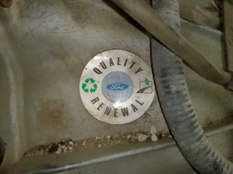

Well, over the weekend I went to collect the rest of the bits that they guy I bought it off forgot to deliver. He let me strip the other Explorer Sport that was in the yard and take what I wanted at no extra cost, so I was happy.
I picked up new wiper arms, complete steering column with all the wires, wheel and airbag, keys, locks, latches, a box with all the nuts n bolts that he tool off, Rad, tranny and t-case...
Tranny & T-case
Rad
All the rest
Should keep me busy for a while....
