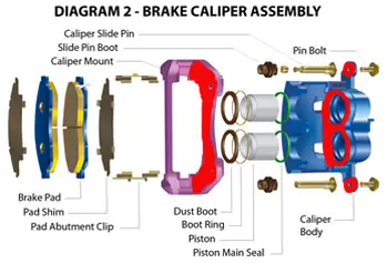

Okay so the parts that would need to remain unpainted would be the red things?
I didn't color the pistons and dust boots but those would need to remain unpainted.
Are these the correct locations?
