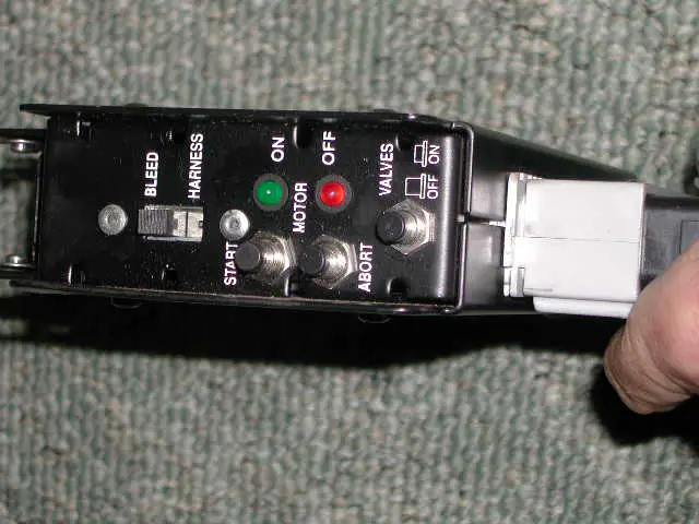

The question no one wanted to answer was the issue of the "is there something special to "'prime' the ABS pump?". On 94 4 wheel ABS models, here is what the FORD manual says:
NOTE:
The anti-lock brake system must be bled in two steps.
1. The brake master cylinder and Hydraulic Control Unit must be bled using Anti-lock Brake Adapter T90P-50-ALA and Jumper T93T-50-ALA. If this procedure is not followed, air will be trapped in the HCU which eventually leads to a spongy brake pedal.
To bleed the brake master cylinder and HCU, disconnect the 40-pin plug from the Electronic Control Unit and install the anti-lock brake adapter to the wire harness 40-pin plug.
a. Place the bleed/harness in bleed position.
b. Turn the ignition switch (11572) ON. At this point the red OFF indicator should turn on.
c. Push the motor button on the adapter down. This starts the pump motor. The red OFF indicator turns off and the green ON indicator turns on. The pump motor will run for 60 seconds once the motor button is pushed (you do not need to hold the button down). If the pump motor is to be turned off for any reason before this 60 seconds has elapsed, push the abort button and the pump motor will turn off.
d. After the first 20 seconds have passed, push and hold the valve button for 20 seconds. This bleeds any trapped air from the brake master cylinder and HCU.
e. The pump continues to run for an additional 20 seconds after the valve button is released.
2. Bleed the brake lines in the following order.
l Right rear
l Left front
l Left rear
l Right front
In another (now much older) thread I showed pictures of the 90-ALA, and for quite some time have advertised a couple of relatively inexpensive Thexton knock off units on the For Sale Forum. I once chimed in with this info but learned to keep my mouth shut. Would failure to follow this lead to "pedal to the floor" ? I dunno. Just my 2 cents.

Bleed more or powerbleed what about the special ABS module bleeding proceedure/tool?
I'm suspecting you need to use the tool and purge your abs system. I've got one you can borrow.

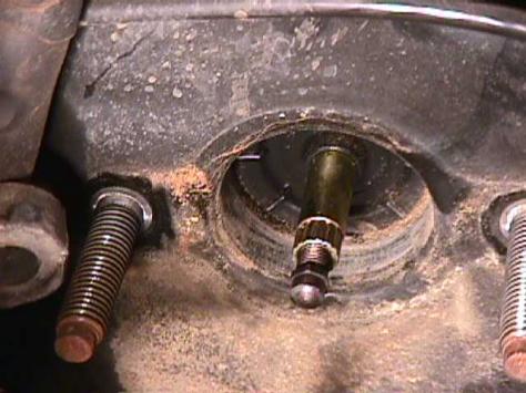

Did you adjust your master cylinder pushrod length after the rear disc swap???
Ummm, no?? Not sure on how to do that??? Do you have a procedure on that?

Like Rick said you might need to check the adjustment/setting of your master cylinder pushrod, Haynes book shows exactly how to set it back to the factory depth.
If you didnt touch it then its not likely your problem.

When you say they "primed" the ABS pump, how did they do that ? The FORD book procedure calls for use of 90P-50-ALA which actually runs the pump. (There are aftermarket ones that do it as well) and they plug into the PCM harness.
It looks like this on the "business end"
and side view

No... if you didn't touch it it most likely IS your problem. You have to lengthen the pushrod over the stock length when you do a rear disc swap. I did mine and without lenghtening the pushrod the pedal went to the floor. You need to take off the master cylinder, and lengthen the pushrod a little at a time. A little goes a long way...You don't want to go to far or the brakes will drag.
This is from Brett Groom's article:
After the brakes have been bled, remove the 9/16 nuts that mount the master cylinder to the power brake booster. (Do NOT loosen any brake lines). This will expose the pushrod for the master cylinder. In order to maintain a good pedal feel after the conversion, the rod must be adjusted to push further into the master cylinder. With the closed end of a 9mm box wrench, hold the pushrod, and with a 7mm box wrench adjust the nut on the end of the pushrod. This procedure is trial and error and will require you to test drive the vehicle in order to get a desired pedal feel.
Okay sorry for the confusion, one of these days I will learn to read old stuff before posting answers.
I wonder if we could get the specs on the length from the factory based on the 91-94 and the 95+, see if there is a difference.
Nevermind....hahaha I will measure off my stock 96 if you measure on your truck PV before you adjust it...
(length of the pushrod from the edge of the booster)
this will tell us how far out you SHOULD turn it, instead of all by feel.
