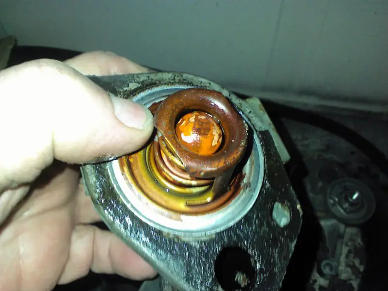

I AM NOT A HAPPY CAMPER... bought 2001 5.0 Mounty with bad Water Pump - 76K miles - Coolant was funky brown so pulled old Thermostat which looked awful with Brown yuck & little Black particles - Flushed OLD components with Prestone Flush - Petcock wd clog with black flecks, I wd have to jiggle it to unclog... blew system down w/ compressed air, flushed some more till it ran clean - Installed new Water Pump, new Hoses, new Thermostat - Ran fine for a week or 2 then Overflow Bottle turned brown again & it runs Hot when idling with AC on OR running 70+ with AC Off or On - Flushed some more, got more Black particles & more brown sticky glueish stuff in Coolant overflow Bottle - STILL Overflow Bottle turned brown again & it runs Hot when idling with AC on OR running 70+ with AC Off or On - My guess is Brown Sticky stuff is some leak fix the PO used... like that's gonna fix a water pump... WHAT are the black particles____?
Do I just buy a new Radiator or will I just contaminate it with brown sticky stuff & black particle flecks ?
Do I use a "mo better" Flush ? - CLR or ?

The black particles might be black pepper, black pepper grounds/flakes have been used for eons to slow coolant leaks.
I am actually a big fan of using pepper because it is quite easy to get it out of the engine when its fixed and it works very well at plugging slow leaks
The brown sludge is likely some sort of leak stop used by PO
How many miles on the 5.0?
When you say it runs "hot" what does that mean? Is it to the top of the stock gauge or?
It sounds like you did not get all of the coolant out of the engine/ heater core, etc and may just need to flush it some more.
It is a good idea to BACK flush the heater cores on these trucks, they are aluminum and should last the life of the truck but all kinds of crap gets stuck in them especially when the PO uses some coolant sealer, it will stay in there unless you reverse the flow
You may have to pull/replace the thermostat again.
You can remove the overflow tank, add some CLR and some pea gravel and shake the crap out of it....this will remove all that hard to get sludge from the top edges
Once the system is running clear then you can start to monitor the coolant level and start watching for any external leaks.
Running hot can be caused by a few things, the 5.0 is not known for this. Usually it is a plugged radiator, defective thermostat, or weak water pump....sounds like you already took care of two of those.

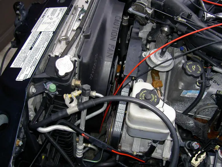

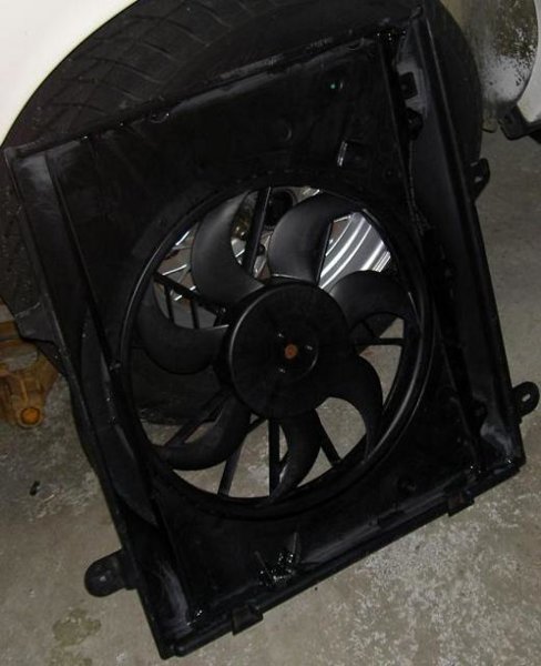

That fan and shroud doesn't look strong enough for the large radiator. That is limiting the heat transfer somewhat.

10 Amp 14 INCH Pro Air 30290 mounted on Galvanized Steel Shroud... its solid to Rad - I got my "inspiration" fm Aftermarket that use Aluminum Shroud (pic attached) - W1209WK digital Controller that I REALLY like & 40 Amp relay... the Mechanical thermostats were crap - 2 more 4 Inch Spals on twin tranny Coolers triggered fm AC Clutch by a 2nd new 40 Amp Relay - I rationalized that I have no "air flow' probs as it only heated up at 65-85 w/ AC on & plenty of Air flow at that speed - SO>> given the FUNK in rad I think what I have is coolant flow prob - I wd think V6 Rad wd be 1 row so that cd actually help clearance BUT I hv no clearance prob with the Stock 2 row... note that Rad fan is mounted on FRONT of Shroud so it uses that dead space between Rad Ends & Core.

Yeah that fan shroud blocks about half of the air, so far the excess cooling of the OEM System is doing fine. My comment is based on possible future Summers, it might be an issue at times.
I have an OEM Volvo fan in my 99 V6 truck. It barely fits the thickness space, but it's a factory Volvo shroud cut down and epoxied to the stock shroud. So I have good airflow, but I worry about the epoxy attachment. My V8 truck I plan to install a Flexlite 190 which others have made fit also.

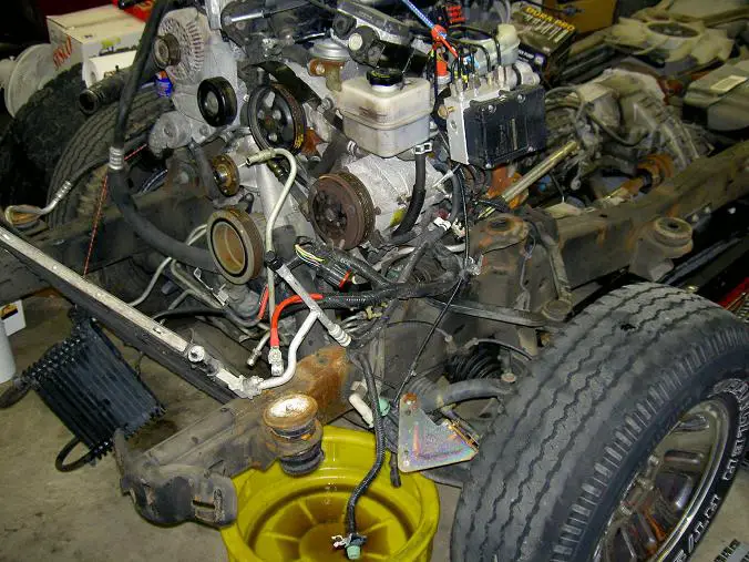

The V6 trucks also had both single and double core radiators, Ford changed both to single around 1998. So you can find all four variants if you need to. The V8 radiators is hell to install, once you know exactly what the trick is, then it's only very hard. The V6 radiators do not have the condenser mounted to it, so the radiator just slips up and down to R&R it. To skip the V8 unit condenser issue, acquiring the V6 mounting bracket is a nice upgrade.
I'm not sure but it may be possible also to use the V8 radiator still, with the V6 bracket holding the condenser in place. I haven't test fitted any of that myself, just read and understand it. I had my V6 truck completely apart, with the AC system lifted off of the engine.
I’d be suspect of the cooling capacity of 120watt fan.

THANX AGAIN GUYS - 14 inch Rad Fan is 10 Amp, said to pull 1600 CFM - That DOES look like a 16 inch in the "Cooling Master" Pic I posted - I had the 14 Inch fan & the 14 Inch AC Duct flange laying around fm previous projects, as well as a 9005 Halogen Relay Harness that was perfect - I will drop lower Hose again ( I did that when it last ran Hot) when I remove the Blue Devil Flush that's been in a couple days now - & Yes I'll whip up fitting to backflush Rad w/ Lower Hose off - While down there I'm going to mod the lower air dam setup to be more like the setup on my 2005 Expy Limited AWD for better Hi Speed Air flow - Expy is enclosed fm back of Bumper to back of Rad... so no gap like the Mounty setup - Running right at 195-200 in all modes but ambients only 60-65 this week, I need at least some 80's & yes this Summer will be the true test - Overflow is still clear, it turned brown when I had Hot probs on Interstate w/ AC on - It was fine in all modes at 80 degree ambient before overflow turned brown again - BUT... if (or when) I have Hot probs w/ clear coolant then yeah I hv Air Flow prob & I'm going to try 2 Flaps on the Shroud like on a 7 series BMW Shroud I have laying around (see pix) - Now I will just use a hole saw in Shroud & a simple pop riveted hinge with a LIGHT flap in upper rt & left corners of Shroud - Of course Flaps open at highway speeds.

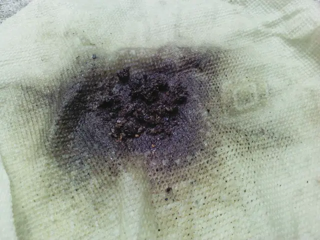

UPDATE - For a couple days I ran 2 QUARTS OF THERMOCURE... $17 a Qt at Walmart in it - Debris & God awful smelling very blackish fluid came out - Did copious amounts of flushing of course - Running cool w/ 50/50 Anti Freeze mix but only a few days in the low 80's so no real test.

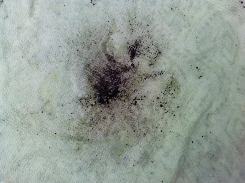

UPDATE - Much better but still some blacks Flecks filtered from the 2 gallons or so of Anti freeze readily drained via Petcock - I'm getting the feeling my 5.0 CREATES these Flecks for a living ~! - Running cool w/ AC on in traffic but ambient temps still only 80 tops so___?
It’s just a really rusty block. You’ll likely always have them.
Yup I agree - 2 Qts of CLR for a couple days - 1 Qt of Red Devil Flush for a couple days - Then a couple days w/ 2Qts of Thermocure FINALLY got its 'attention" - That was some God awful smelling Black fluid that came out after 5 days of running it in system - Only after unplugging Petcock receptacle of what it "freed up" did I finally get a big solid stream with Petcock removed - Lesson is if ur Petcock 'trickles' & u don't have big fat stream of Fluid when u pull Petcock u have a LOT of Flushing to do~!
