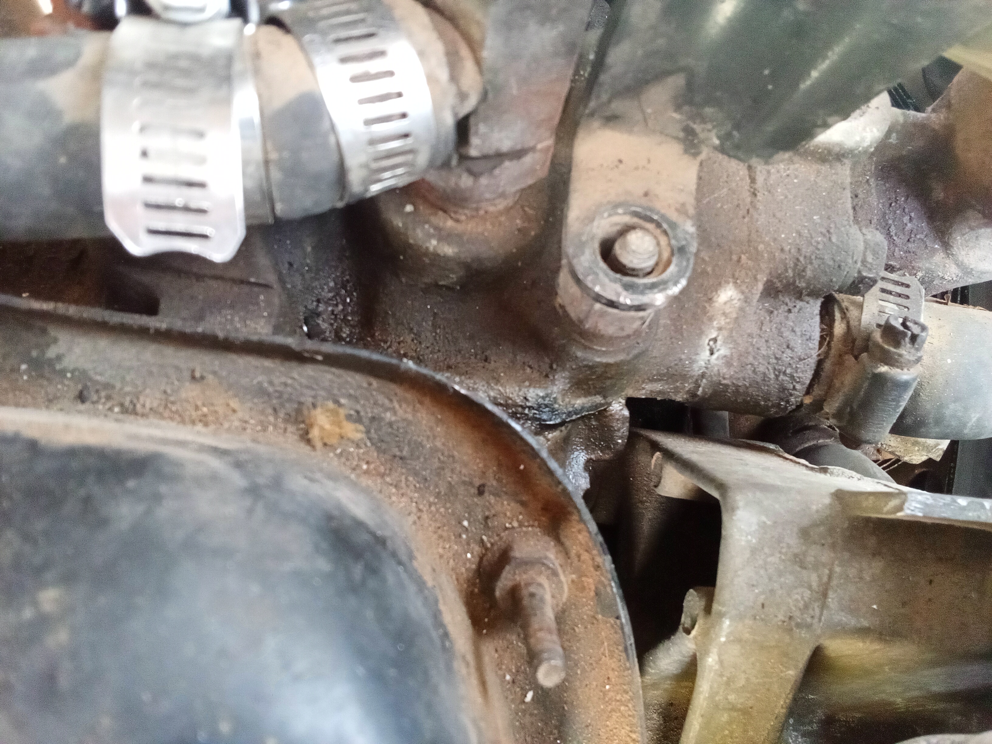

Rust is like cancer. It returns, spreads and grows. Factory coolant never changed or pure water will do that. I'd be confident the head could be ran as is. The JB Weld will protect the metal as much as it will help seal.
I'm basically adding tiny bits of JB weld, letting it thicken up a bit, then gently running a razor blade over it to make it flush.
To be honest, I didn't prep the metal before applying the epoxy, but the small area I was applying it to didn't really have rust, the rust started a bit more inside the hole, so hopefully I'll be okay.
That looks good.
Don't disturb the epoxy until it cures, then, sandpaper on a block to level it down.
Shaving with a blade will pull It off the repair area..slightly but it will pull.
You'll just have to wait overnight for this one. Hopefully you didn't use the quick set version . It's about 25 percent strong as original.
This is at the “dead end” of a water jacket port. Water will be flowing into this cavity and then through the small hole in the gasket. Scale and crap buildup in these cavities over miles. That epoxy is trapped. Even if it did break free from adhesion it is still not gonna go anywhere but sit there until the next lucky wrench jockey pulls this head. We just don’t want it to break free and clog the hole
I put the epoxy on yesterday and smoothed with razor blade, and waited overnight.
Now this morning I applied a tiny bit more, and plan to wait til tomorrow and sand it down.
I used original JB weld, it says its 5020psi strength.
