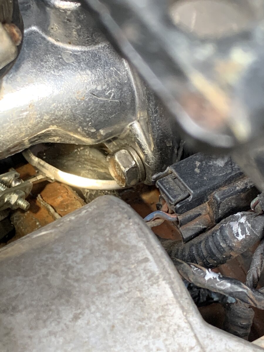

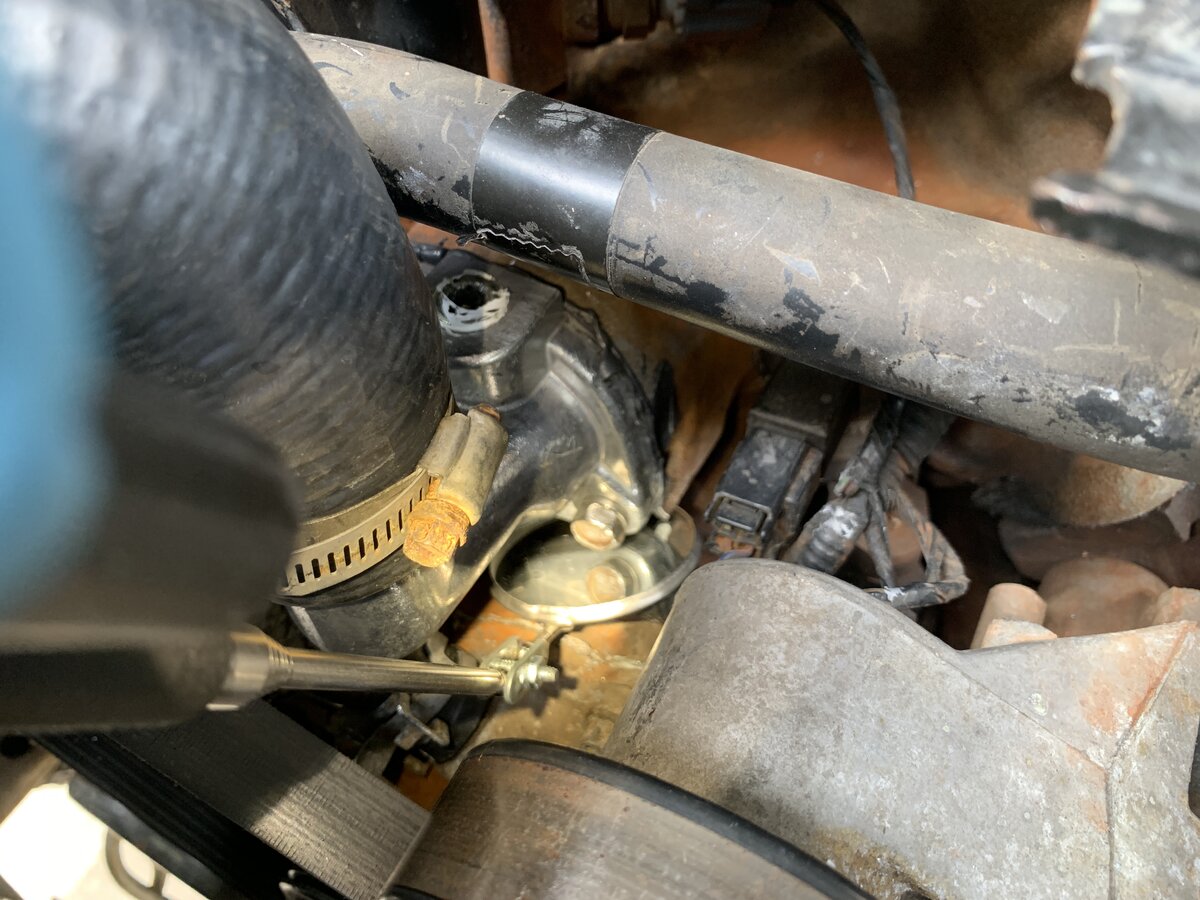

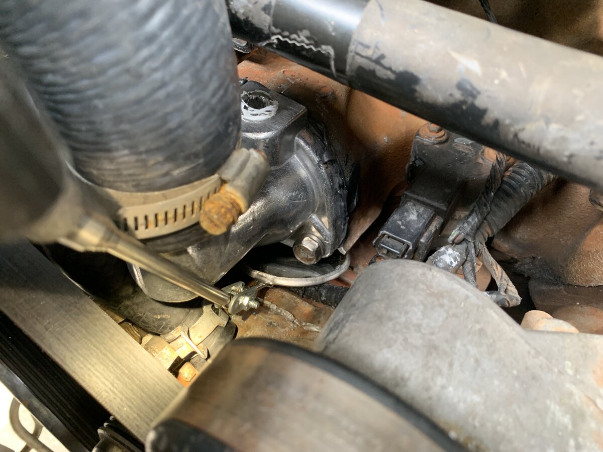

Here are a couple of pics. Can’t see anything leaking, but in these it’s really hard to see anything at all. This cooling system is a real mess to look at!

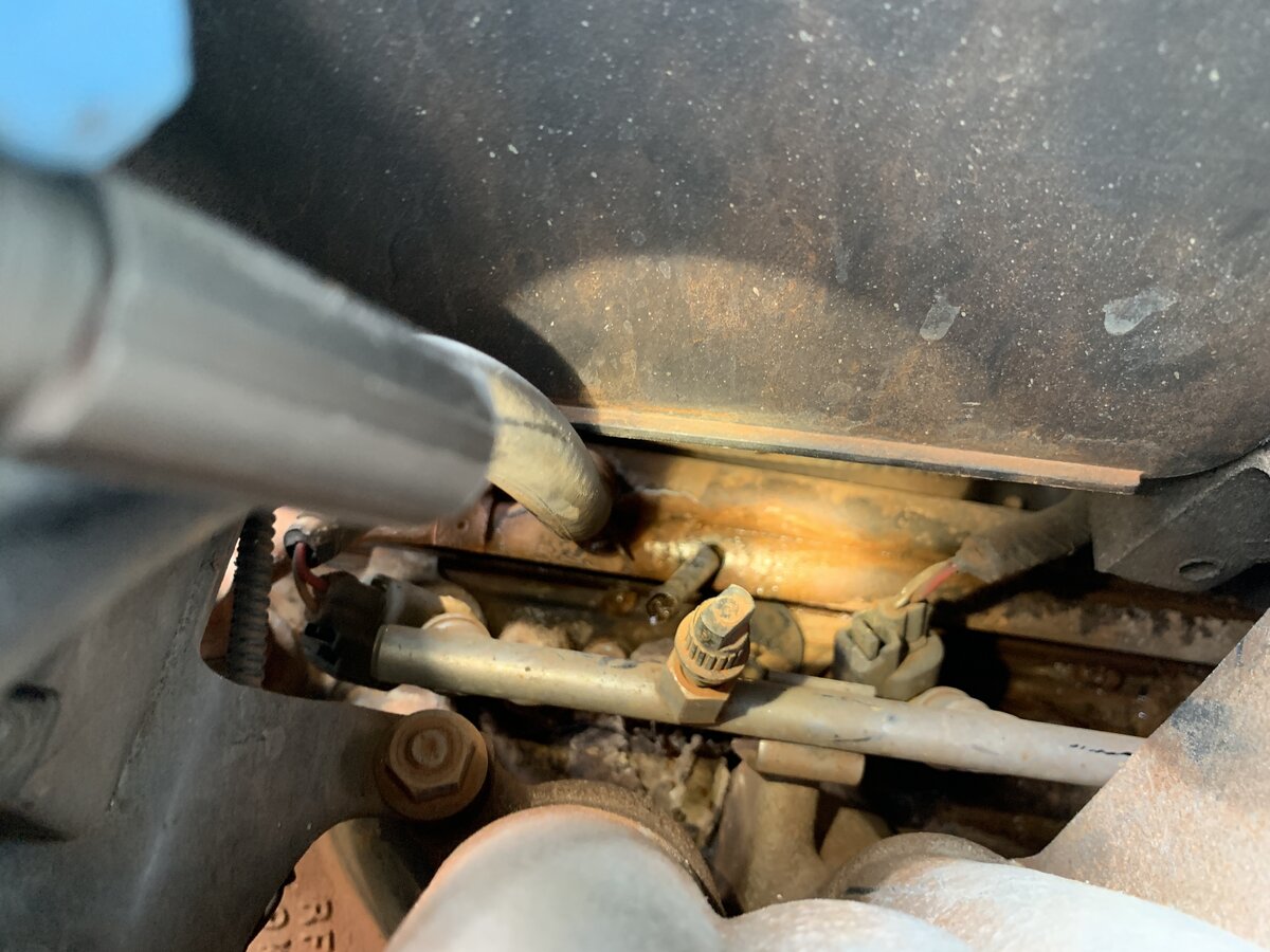

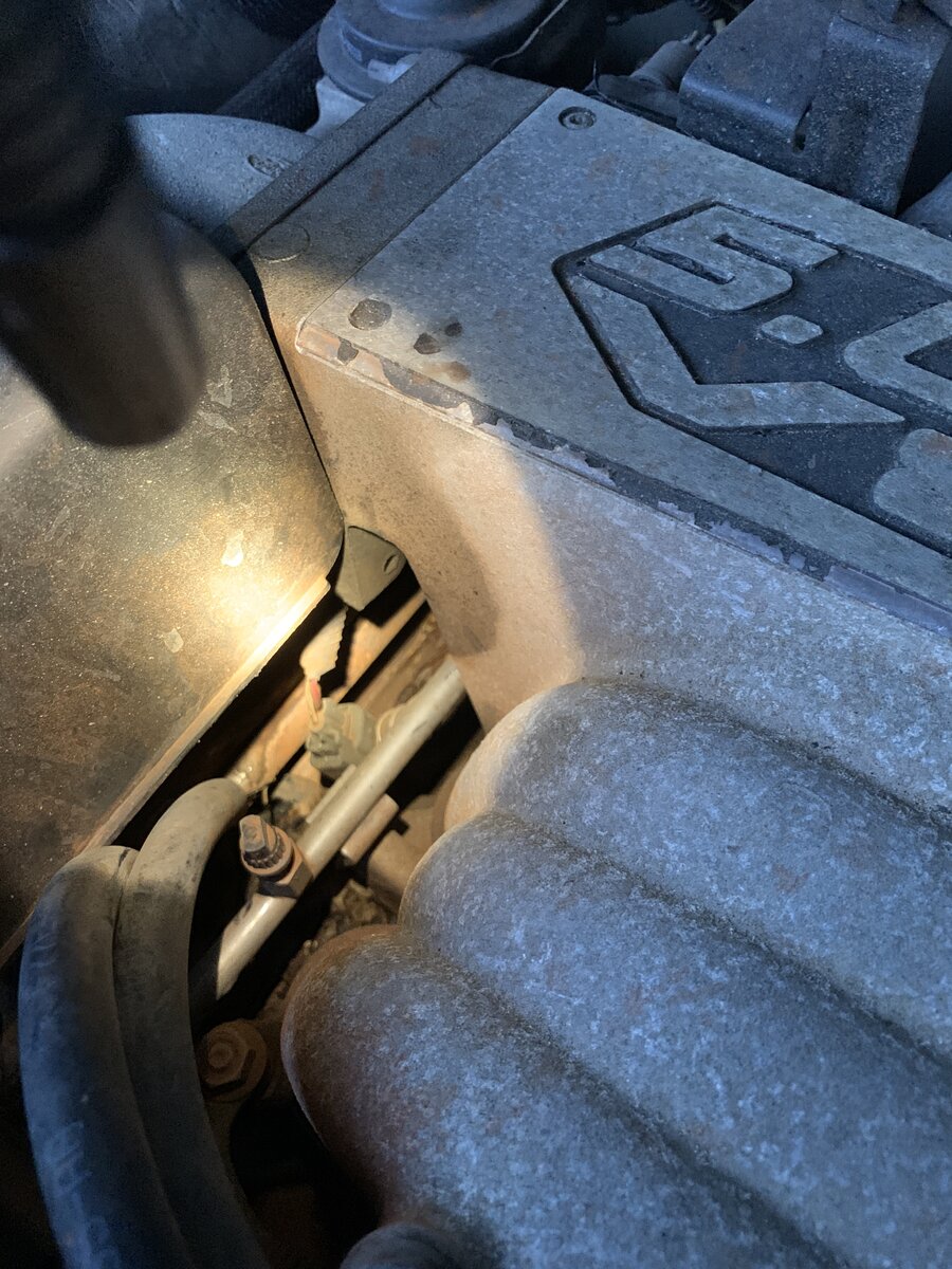

And the leak is right around here.
Found it! The barb for one of the smaller coolant hoses is split right on the heater pipe. Guess I'll make a stop at the junkyard for a nicer one.
Very good, now you can fix it.
I'd clean the engine bay before tearing into it for the pipe, just a mild engine degrease and water hose spray down. Use some anti-seize on bolts and thread sealant on the water pipe threads etc.
