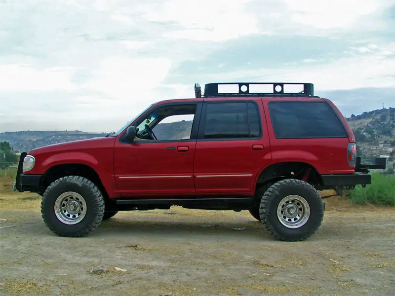

Here is the idea in PhotoShop. Let me know what you all think… top one is how it is now…

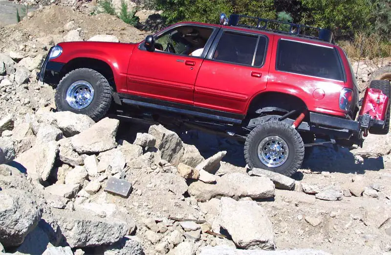

Well, I’ve been running the truck for a couple weeks & except for a couple snafu’s everything is better than I expected.
On the road, the truck rides great. I really notice the difference with the outboard shocks, the ride is as good as or better that it was stock, but the big difference is the stability. The body roll has been greatly reduced; almost gone! It’s kind of weird really, but it seems to lean into the turns now rather than flop to the out side…
I installed 4.88 gears and I’m happy I did. Most of the wheeling I do is slow driving along the beach or out in the desert & I wanted more torque when loaded down with all our gear. On the Hwy. at 70 mph, I run a little under 3,000 rpm’s; this is about the same as I ran with the 3.73’s and the overdrive off. There is a huge difference in power now, before, I could hardly make it up some hills on the hwy. & even had to down shift a few times. Now, the truck just pulls up & over everything with no problems, in 4 low, this thing is a torque monster.

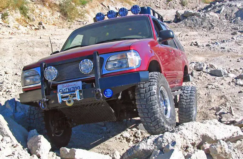

The biggest change has to be the front locker! I can’t believe the difference there is having that thing up there… I wasn’t sure I wanted to loose the auto 4x4 assist, but everything you hear about the difference is true, the front locker let’s you slowly crawl up almost anything you can get clearance on. I could have saved the money for the Ected in the rear and just left the LS back there, because in 2 wheel drive with the brown wire mod, even locked, the back breaks loose on steep dirt hills. But if I leave the Ected off (in LS mode) and just flip the switch to the front, it just pulls like crazy & walks right up! Even if I get stuck halfway up a steep hill and dig a couple nice holes with the back tires, flipping the front locker on pulls me right up & over.
I went out to a local quarry & crawled over a bunch of rocks & was really happy with the front locker performance. Before, I’d really have to gun the engine & ride the brake to get the front tire up on some of the bigger rocks, now with the locker, the front easily pulls itself up.
The truck felt heavy for the first few days till I got used to it. We added a lot of weight with the bumpers, winch, sliders etc… & I could feel it was sprung down a bit. Bumping the Rancho’s up a couple ticks helped take the bounce out of the front. All & all I’m very happy with all the mods. There are a couple issues I need to resolve.

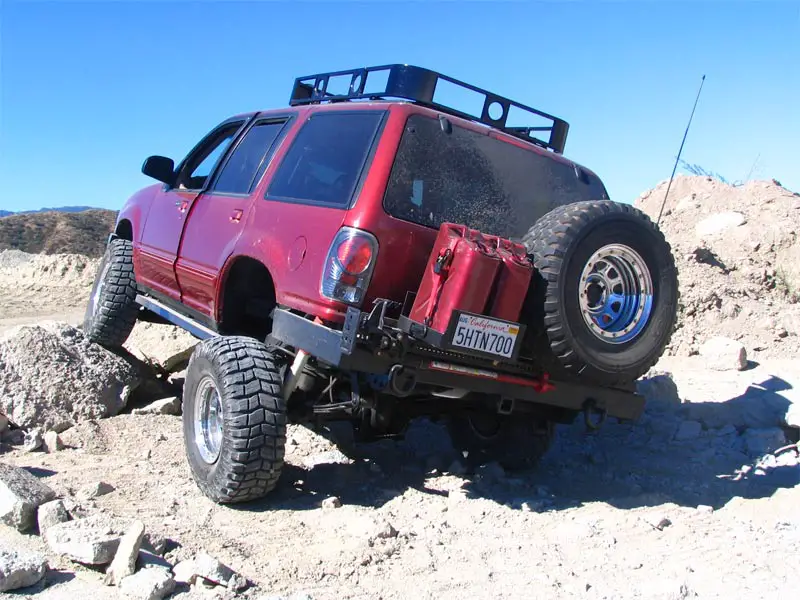

We took out the overload spring and the add-a-leaf in order to get the truck a little lower in the back after the SOA. Now, at full stuff the spring inverts on the stuffed side, works great for articulation, but probably a little rough on the springs. I need to maybe put back in the overload spring or add another leaf that doesn’t have so much arch, or get a new spring pack made… Any ideas???
I also ran into the same problem Dreamr talked about in this thread; http://www.explorerforum.com/forums/showthread.php?t=128134&highlight=flashing+4+low
The 4 high-4 low lights flash 6 times and the computer goes into safe mode till I restart the truck, then everything works OK for a few miles & the lights start flashing again. I’n Dreamr’s case, he was concerned that it cut out the control trac and locked him out of 4 low. I’m inclined to ignore these lights because with the locker up front, I don’t use the control trac anyway & I can still shift down into 4 low. Even after the lights flash, I can still get 4 low and flipping the brown wire mod switch gives me power to the front, so I don’t know what this is doing… Dreamr did some pretty extensive trouble shooting & still has some issues. I talked to a couple other people that installed new gears and electric lockers & haven’t heard of anyone else with the same problem, so I think it’s an issue with the install on Dreamr’s and mine.
