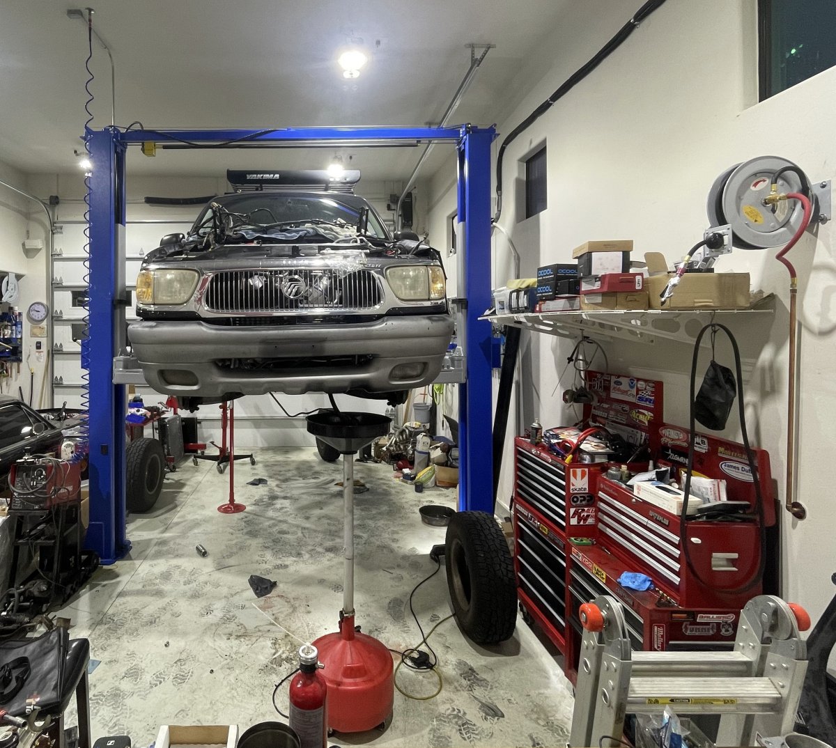

The transmission and t-case are back and ready for installation! The transmission received a proper warming up, with improved frictions made of carbon/kevlar. The front drum was replaced with a billet steel version of it, new direct drum (not billet), J-mod in conjunction with a B&M shift kit (which was already installed). The converter is a Precision of New Hampton unit with 2300-2800 stall rating, anti-balloon plate and furnace brazing throughout. It also has a Luk clutch internally, so that will be a nice upgrade. T-case received a refresh with new seals and all new bearings, it looked fine internally and it doesn't look like there's much that can actually go wrong with a 4404 due to their simplicity, but we'll find out!

I just cleaned the **** out of my shop, it took me about 4 hours of scrubbing and mopping. Planning to stab the transmission in tomorrow.

The transmission is in! Not accomplished without a transmission jack with a tilt head. It's super tight in there! The service manual immediately calls out for installation of the trans dipstick, so glad we got that in as the main assembly went in... it would've been impossible to get it in place otherwise.
