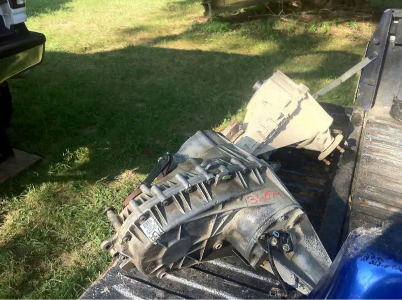

A few pic of my progress

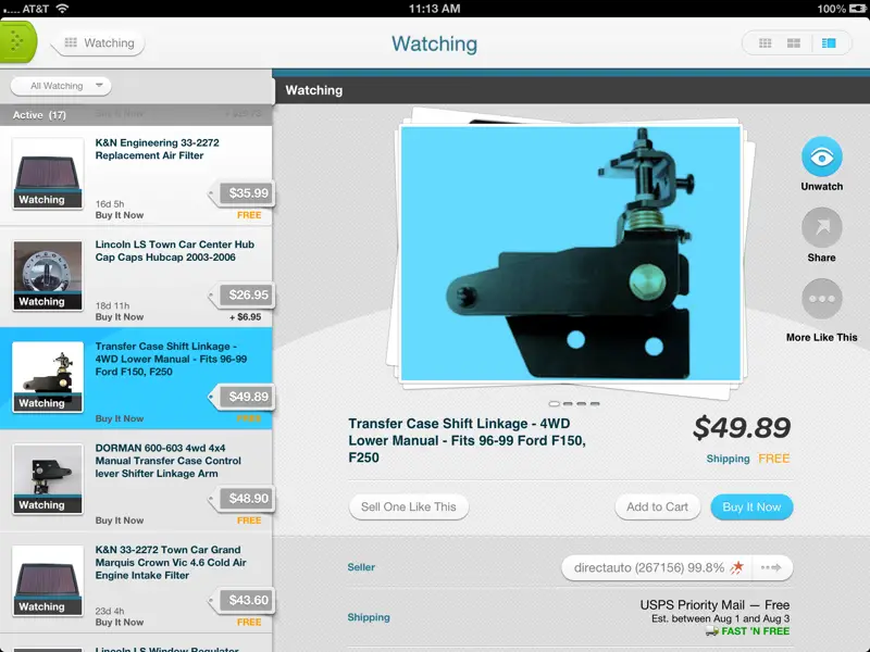

The shifter is the hard part to find, so be sure to ask for it when you talk to them.
