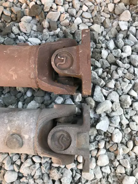

Sorry to be making an extremely long thread even longer, but I’m getting confused regarding rear driveshafts.
I did the BW4406 swap a couple of years ago and recently dented my rear driveshaft, so I’m looking to replace it. It currently is the double cardan variation, which I actually got used from someone on here, so I assumed at the time it was the correct one from an Expedition, although now I’m second guessing that for a few reasons. 1) I had to get it shortened about 1” when I did the swap because it seemed too long, and 2) it has never slipped into the t-case output easily, requiring several minutes worth of pounding with a dead blow to get it to slide on. 3) It has always leaked a tiny bit of fluid between the output seal and slip yoke, even with new seals.

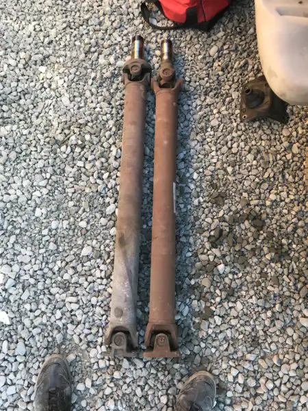

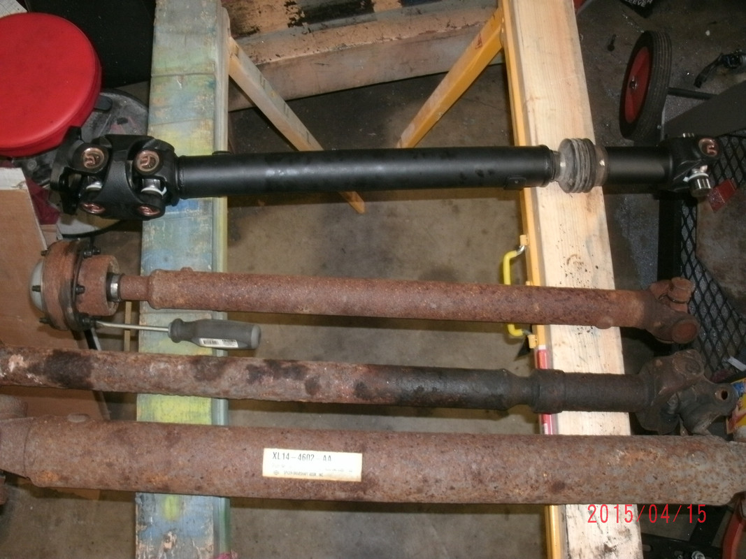

Fast forward to today, I went to a junkyard and found 2 different styles of rear driveshaft, both of which just have a single u-joint at the t-case but are totally different in several ways. One Expedition definitely has a 5.4 engine, and I’m pretty sure the second does as well, although it’s hard to identify with the condition the vehicles are in. Both have 9.75 rear ends, and 4r100 transmissions, so I would have thought the driveshafts would need to be the same. I don’t recall either vehicle having air suspension either.

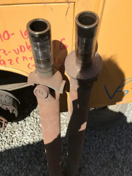

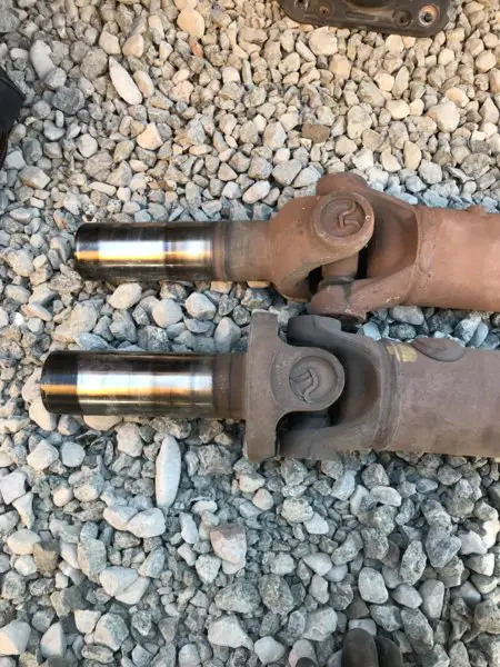

You can see in the pictures the differences. They are about 1” different in length. The slip yokes are totally different, the shorter shaft with a more rounded yoke and only one “registration” spline vs the longer one having a larger squared style and 2 of those registration splines. You can also see the splines stop before the end of the slip yoke on one, and go all the way to the end on the other. The rear flanges that bolt to the rear axle pinion are also different, although the hole pattern is identical. Diameters of both the shaft and the slip yoke are the same as far as I can tell.
I’m having a hard time finding pictures of which driveshaft is the correct one, and in hopes of avoiding the tedious removal of my current driveshaft, I’m hoping some of you can offer some clarity. Maybe you guys can measure your non-double cardan shaft lengths?

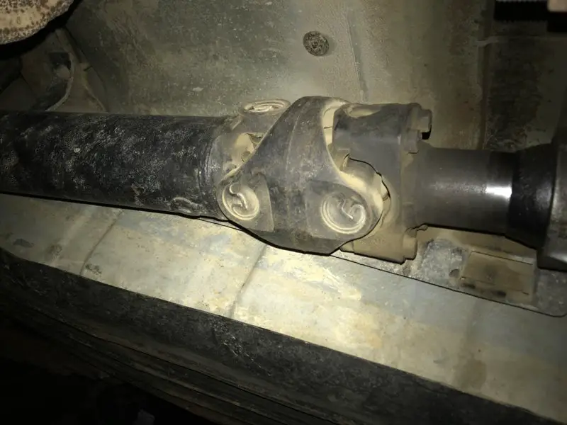

This is my current driveshaft.

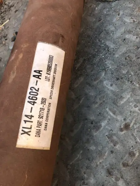

The bottom DS in my pic shows the one I used and it worked perfect. The part number matches your second to last pic.

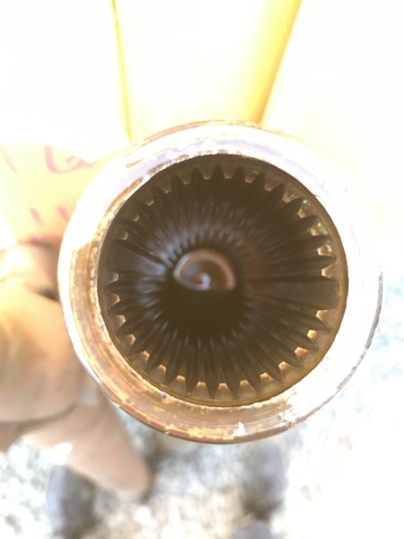

I am sure you already sorted this out but, It should NOT require pounding to get the d shaft to slide into the tailhousing! It should slide easily and fit snug to the tailhousing seal
Getting the right rear D shaft can be tricky, there are so many different ones out there. The ones I used originally when I first did this to my 96 Explorer were from a 97-98 expedition with solid rear axle and a 4.6L engine
Since those have become very hard to find I usually just get the rear shaft from the F150 (4.6L trucks) and have it shortened to fit my project (re tubed)

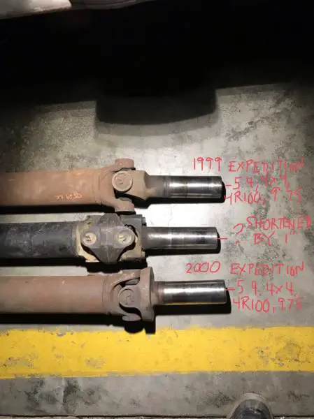

I went back to the junkyard and got both just to be safe, and the shorter one that SWIGIN mentioned was the better fit. Surprisingly the old one slid out of the t-case without any hammering, but the new one did require some persuasion. Must be something about the output shaft on mine.

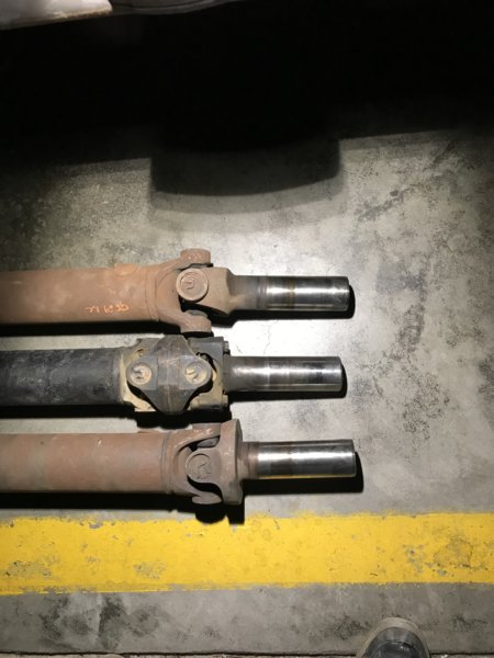

By the way, here are a few more comparison pictures for anyone who’s interested. The double cardan allows a tiny bit more angle, and the slip yoke also only has one “registration” spline, although the output shaft just has regular splines completely around the shaft so they really make no difference. Also the double cardan is slightly smaller in overall diameter. The yoke of the single u-joint shaft kisses the gas tank cover.
what are those 3 shafts out of (for reference)? Should put the info with the pic

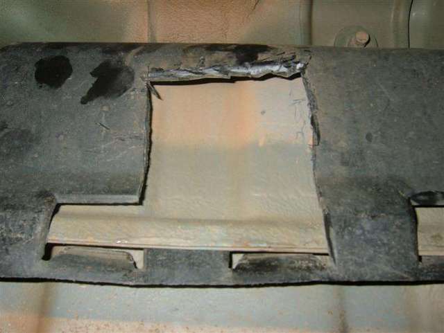

I have had to hack away at gas tank covers more then once, the plastic cover gets trimmed near the driveline when they have that big round flange.
Hopefully that helps. Also neither top nor bottom came off vehicles with rear air suspension. And that’s a parking garage, I live in an apartment building.

I would have to go back and read but Im 99.9% sure the rear d shaft I used in my 96 was from a 97 Expedition 4.6L and it bolted in. The front shaft bolted in too but it was TIGHT. Years later I learned that I can remove 1" from both sides of the slip yoke (grinder and file) and make the front d shaft slip right in (1" from both sides = 1/2" overlap gained)
I didn’t even try a 4.6 shaft because everyone says the 5.4 is what is needed. The one from the 1999 expedition is what I used, which is slightly shorter. Surprisingly, the front shaft (presumably from a 4.6) bolted right in for me, which is nothing short of miraculous considering it’s a 2nd gen with TTB.

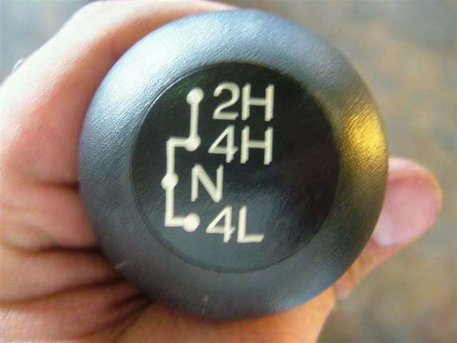

4406 Lockout Switch (4wd indicator sensor) 4L327E440AB

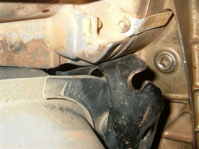

7. The front of the tank is held by a bracket that is bolted to the frame. Remove the two 18mm bolts that hold the tank to the bracket. Remove the four 15mm nuts that hold the bracket to the frame. Two of the nuts are on the bottom of the frame, the other two are on top between the frame and body. Remove the bolt pairs from the frame. You may have to tap them with a hammer.
8. Remove the bracket from the truck. The end of the bracket needs to be bent inward to allow for the bigger 4406 case. I don’t really know how to explain how to do it, but it’s easy to see what has to be done when the case is in.

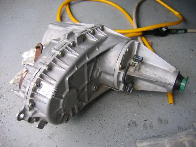

Here is what it looks like with the case in:
