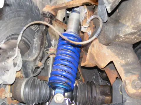

reason for the new co's is it seems there is not enough droop on the 19 inch long Fox ones in there now, and when set to ride hieght at present there is very little droop,, and the springs are cranked to way past 1/2 way on the shock bodies,and my a arms are just a hair below being horizontal, and that kind of scares me , in fact at rest , the springs i have now are very close to coil bind.
they are a 12 inch spring and i have them compressed to 10 inches hanging on the limit straps.
it was all in the way they were mounted and the braided lines were run that made it work out, , here is how it is, ,

i did twist them a bit so that here was tension on them even when at nuetral steer so that they would take care of themselves when moved

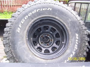

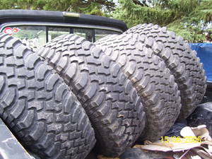

I had a tire problem with 1 of my Cooper STT's, so i got a used set from a local tire guy to hold me over till i could buy a complete new set of 4,
he had these BFG all terrain in the size i wanted for $440, so i got them and put them on myself,
i have access to a tire machine,
i didn't balance them but i have dyna beads in them smooth ride,

Those tires work great in everything except deep mud. They also last a good long time, you should get plenty of miles out of them. A little wider(11.5"?) than your old ones too, that's going to help a ton out in the trails as well. Plus they look better IMHO.
they are actually the same size as the Coopers were, but appear narrower , but i tried them out already, they work good,

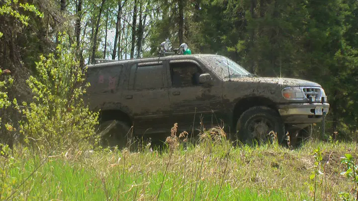

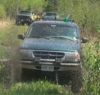

and than a day out in the mud,,
some of the holes were deep enough that i couldn't open the door to get the winch hooked up a few times,,,
took 1 hour to wash it on top, and 2 hours on the interior, after that mud day,,,
i need wider tires, and taller too ,
this was really alot of fun,

I love mud!!! Looks like a great time it will take weeks to get mud out of everywhere.
time for new springs,
the line shows where they were, and you can see where the adjusting collars are now,
big difference, ,
