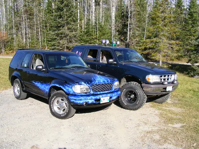

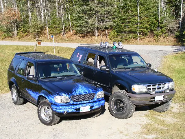

and we took some photos of both our rigs sitting together, ,
i will wait to see what he posts for pics,,
had a visitor today, and took some pics,
Tim has some too, he may post a few,

well i get there to see this (pete waiting)
we start to chat, then i notice this (dam that man is fast)
then then photo shoot begins!
:can:TEAM CANADA!:can:
to give everyone a idea how big pete's truck is now......
he was also saying he needed them in a hurry sooooo (well not really, but....)
great to see ya again and chat for awhile. sorry couldnt stay for supper, but had to get back. it was a good day!
Yes it was, was nice to talk and the photos turned out very nice,,
