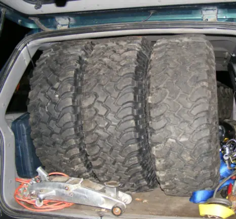

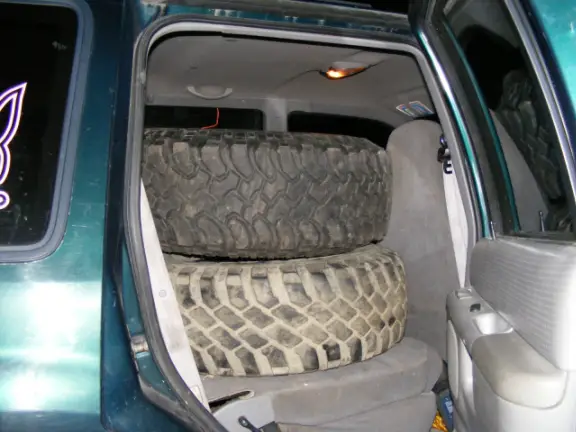

I went and picked up my 35's today, and brought them home ,after figuring out how to pack all 4 of them and a 33 inch spare in the Ex..
It was tight but i made it work, lets just say all i could see in the rearview mirror was rubber,,

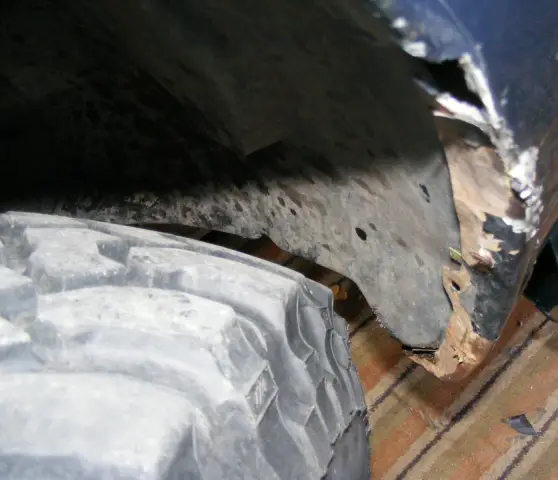

so i cut into the front fender at the bottom,
than i cut deeper into it, and than put the first piece back on , but overlapped it,
once it was welded back in place you can hardly tell from a distance,
once the passenger side was all done, i rolled it out to the sun and got some photos,,
Than i took it out for a drive, handled good , and smooth, next it is going to need an alignment as the wheel shimmies just a bit,,

it leaves a nice factory looking edge out there and won't dig into the tire,,
also gives something to refasten the plastic liner to,

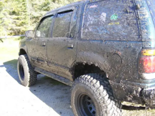

i put on the big tires, i had to try them out,,
Looks good, like the fender trimming.
tire clearance is good, i pushed the plastic liner back when i welded the lip back on, after cutting alot off the bottom of it along the contour line,
