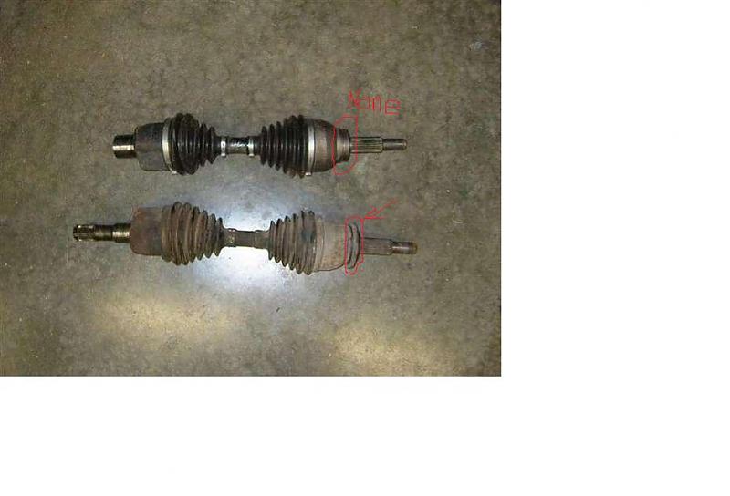

one thing you may want to add is that there are races that are on the old c/v's that need to either be replaced or reused heres what i am talking about, i realised they were there after i put it all back together
sorry i suck in paint
Those are the dust excluder seals. A lot of people just leave them off. They should stay pressed into the spindle, but sometimes they don't.
