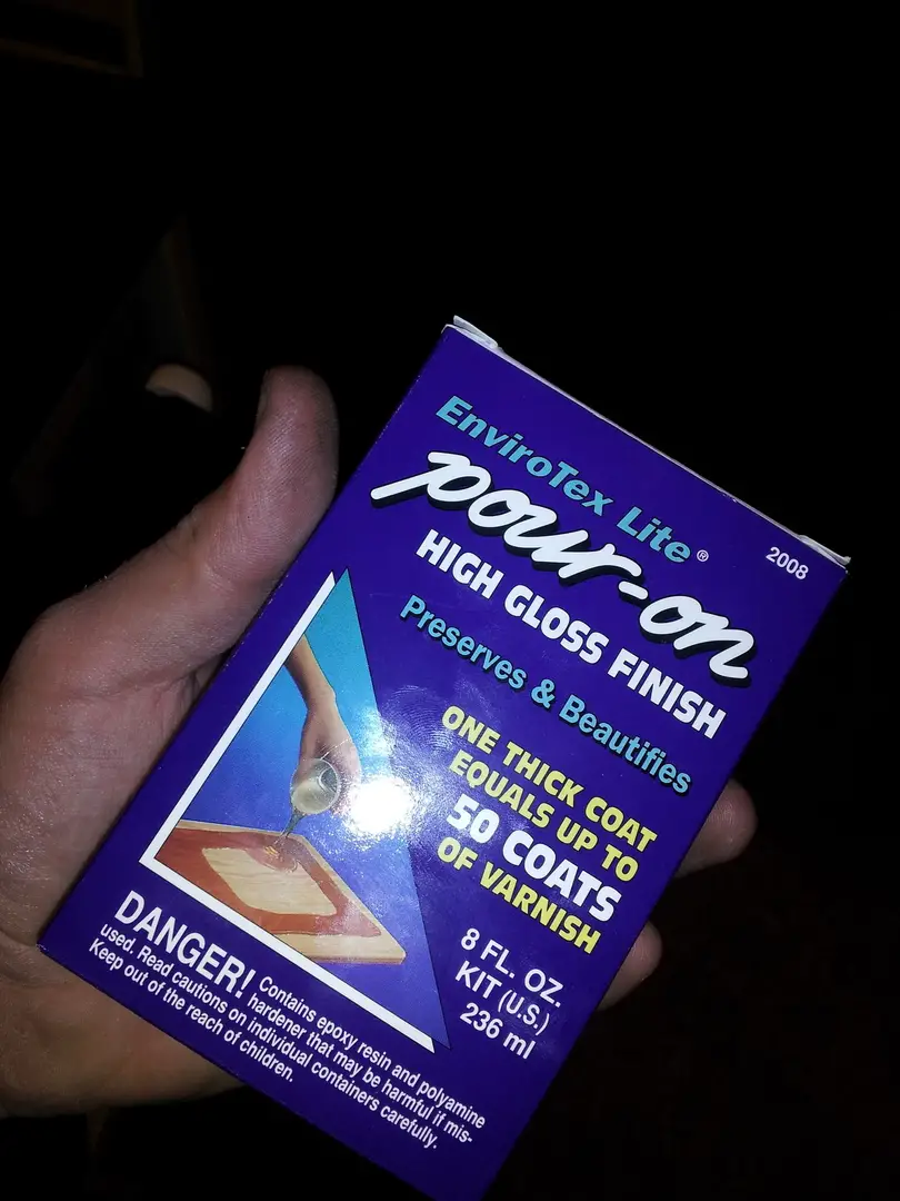

6. The last step is to use a chemical epoxy called Envirotec epoxy it is avalible at Hobby Lobby, Target and on line for about 10.00 you need 1.5 ounces of it for two emblems front and back. Mix it acording to instructions and slowly fill the face to include the grove around the face. Let it sit and after 12 hours you can form it to how you like and after 24 hours they say you can even sand it I havent done that.
