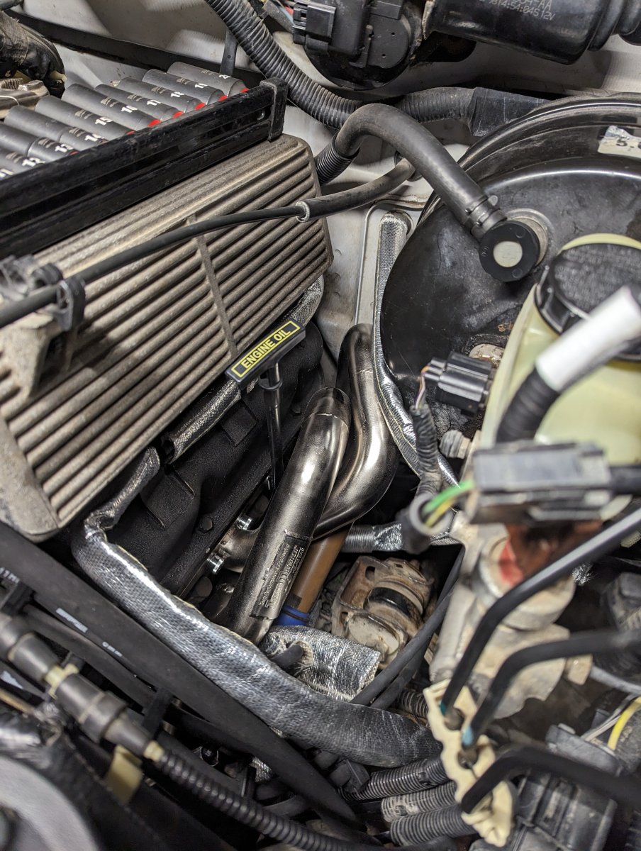

Still waiting on my EGR tube but I've been keeping busy making heat shields. I bought a couple rolls of the Velcro sheath material and have been cutting sections, sewing up the ends and installing them on brake lines, fuel lines, and the hood release cable.
Smart! Ac lines too!
Good idea! I only got sheath material in 1/2" ID and 3/4" ID, I'll have to see if the 3/4" ID can fit over the A/C lines.
Can you show us this material? Who makes it etx
I generally use DEI products for everything like this (header wrap, plug wire sleeves, etc.), but they don't sell a 1/2" ID Velcro sheath. Since I didn't want to disconnect lines again nor did I want to use bulkier material than necessary, I bough some cheap material off Amazon.
The only negative reviews I read were about the branding tag not being heat resistant (easy enough to avoid, there's only one tag per 10' roll) and there were complaints that the threads come undone after cutting them (duh!). I just cut sections to size and fired up my 50s Singer sewing machine to backstitch over the loose threads and zig-zag across the cut ends to stop them from fraying. I can take some close-up pictures when I'm home tonight.
Time will tell how the material holds up, but it looks pretty good to me. I used the 1/2" ID material over brake lines and plug wires and 3/4" ID on the fuel line and hood release cable.

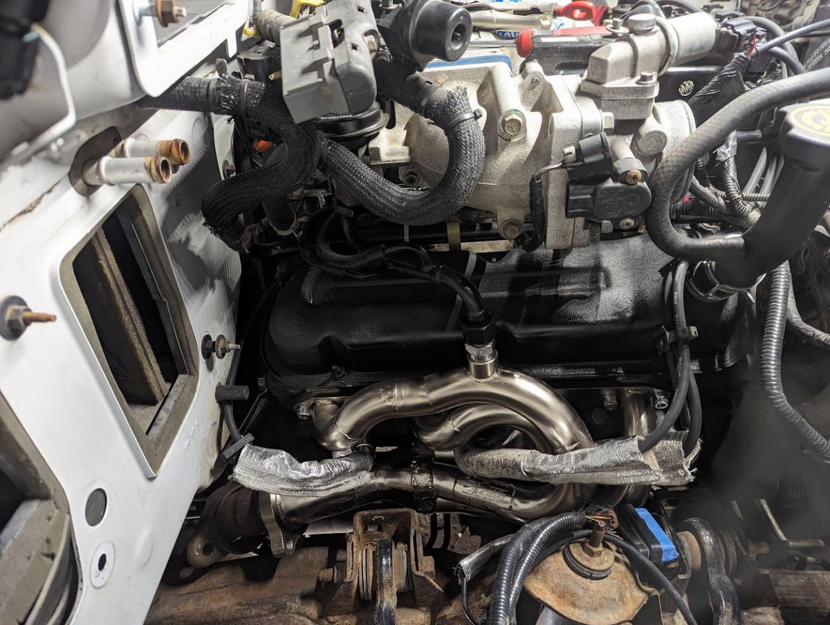

And just like that, the headers have virtually disappeared.
Looking forward to seeing what all the hype about TMH is...hopefully tomorrow!
24+
Horsies you can feel and hear it
Well done! Seriously a big round of applause!!!
Nice work!
I put a similar material on the brake booster, fuel line, HVAC box, steering shaft, under the throttle body/intake tube and HVAC line/orifice tube. It is holding-up well after a few years.
