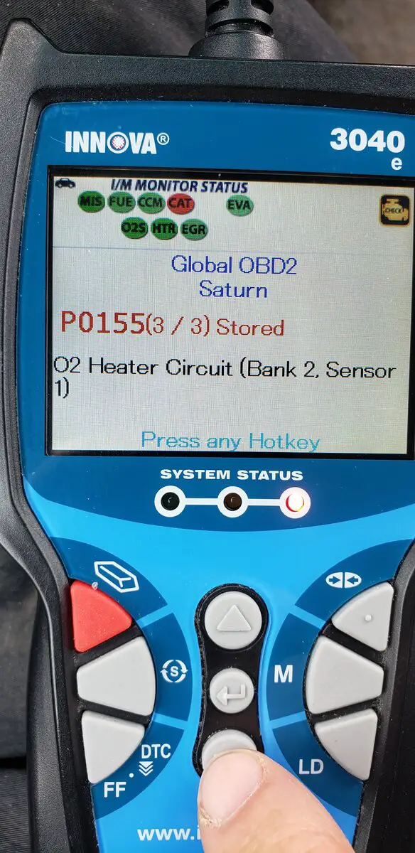

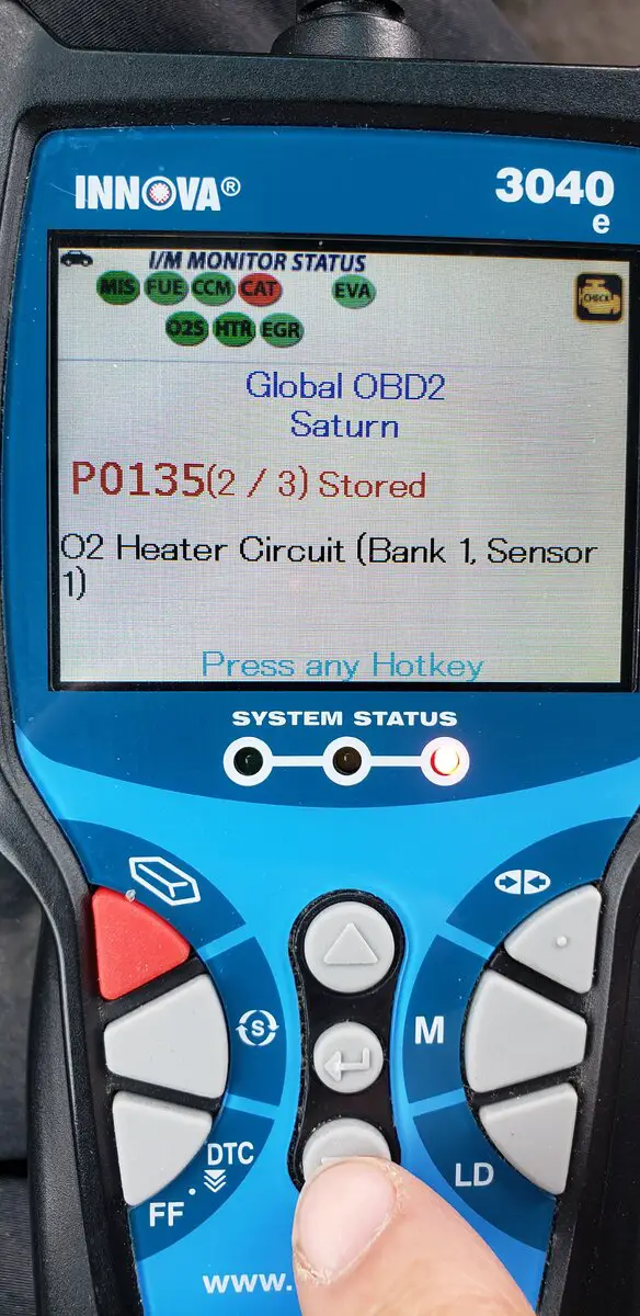

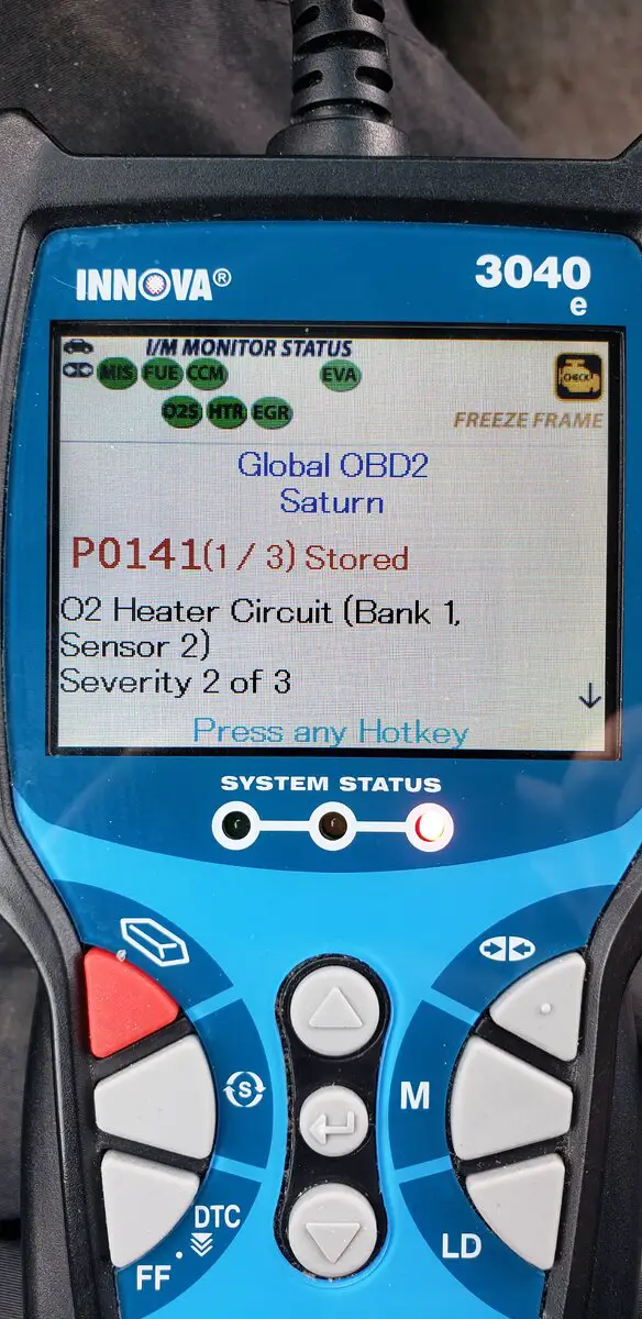

Two heater codes? That is likely a wiring issue or a fuse. Chances are if you replace the sensors, the code will come right back.
3 heater codes.
I feel it could be wiring or fuses but the mech who put the new sensors in said the wiring was still good. He said that the battery on this truck has to be unplugged for 10mins and idling for another 10mins when replacing the sensors and clearing the CEL. Is that true?
Didn’t you previously say the first mechanic hacked up the wiring and fixed it with ****ty crimps?
That’s where I would be looking with all those sensor heater codes.
$20 your cat is fine.
Yes the first mechanic hacked up the wiring harness in the engine bay and tried to crimp it. But I had that all replaced and fixed last week at my main mechanic. That wiring harness right on the engine would affect o2 sensors? I thought the o2 sensors are under the truck right by the sensors?
From the looks of it, since I got 3 codes and it is from each of the 3 sensors, it has to be wiring.

Cat failures are very rare on these trucks, unless they rot away. That is why I said diagnosis is important. So you see where this is going and what bills you can have?
The engine harness could have wires going to the computer and the 02 sensors. Could be a damaged ground wire. Who knows. This is why I hate strange mechanics touching my car.
After this thread you are probably more qualified than many "mechanics." I know cases were new cars under warranty were F*#$d beyond repair. Unplugging the battery is also BS. After a drive everything will adjust. When you unplug the battery you just set everything to the baseline and have to drive anyway.
The O2 wiring runs along the back of the engine/trans, and into the main connector nearby. If any of that wiring was damaged, they could have gotten the wires mixed up when they reconnected them. They all have unique colors, which should make it easy for anyone to trace them or repair them.
You or your mechanic should be able to test the wires from each end, the main engine harness connector, to near the sensor end. Those should all have proper resistance and continuity.
