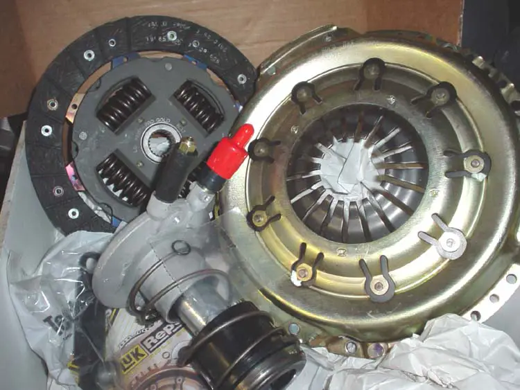

Ups and www.dialaclutch.com pulled through for me today and delivered my clutch kit! :D
BUUUUUT! I see you two have been chatting like school girls at a slumber party since I',ve been gone. lol
Fortune, from your post, YES you have done this before, quite a few times, I use a pair of needle nose plires to get that ring to go in, and give a little push on the hydralic line just before the tug to make it come out.
I'm sorry to hear that you didn't like the LUK clutch, that happens to be just what I bought, the Premium Gold Kit.
The Centerforce II is by far the better choice, but my budget denoted that wouldn't happen this time around, plus Waco Brake & Clutch here also builds custom clutches, and so if this fails I can get it upgraded for not a lot of cash, he does all of our street clutches and mini stock clutches.
They are know to hold 450+ hp.
One of the reasons I bought the kit is because everything in mine needed to be replace, bearings, and the slave so for $258, I figured what the hell.
Now I just have to figure out what the little O-ring is for! haha!

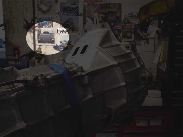

dejello: it's been so long... what's it like to be going about 100mph?
dejello: (refering to the pic in the transmission thread)
Gotta love them 2.73 gears
HAHAH! didn't think about that when I took the picture, guess I'm busted, the worst part is the Texas sun on the leather steering wheel, but at leaset it doesn't ooze black **** like my Navajo, that stuff likes to never come off.

:thumbsup: nice truck in that pic! :D
ROFL, gotta love them Ford vettes, them the sweetest!!!
:nono:
huh? thats the rear of my truck. :)
HAHAHHAA! Ford Vette's! :shakes head:
Yupers, that's your truck on the wall, printed it out for the sticker on your back window.

I've had to replace my tranny and then the clutch a couple months later. It was so much easier the second time around. Removing the exhaust is a must. The o-ring is for the hydraulic lines. I like the clutch I have now. I shredded the stock replacement clutch I bought when I replaced the tranny. I now have a custom clutch from Six States. It is ceramic on the flywheel side and carbon metalic on the flexplate side. Works great. Cost $85.00. Oh also has upgraded springs.

Yeah it had been such a wash for a week trying to get the rig put back together, that the O-ring had me going for about a day, but I got it all figured out though, Thanx.
