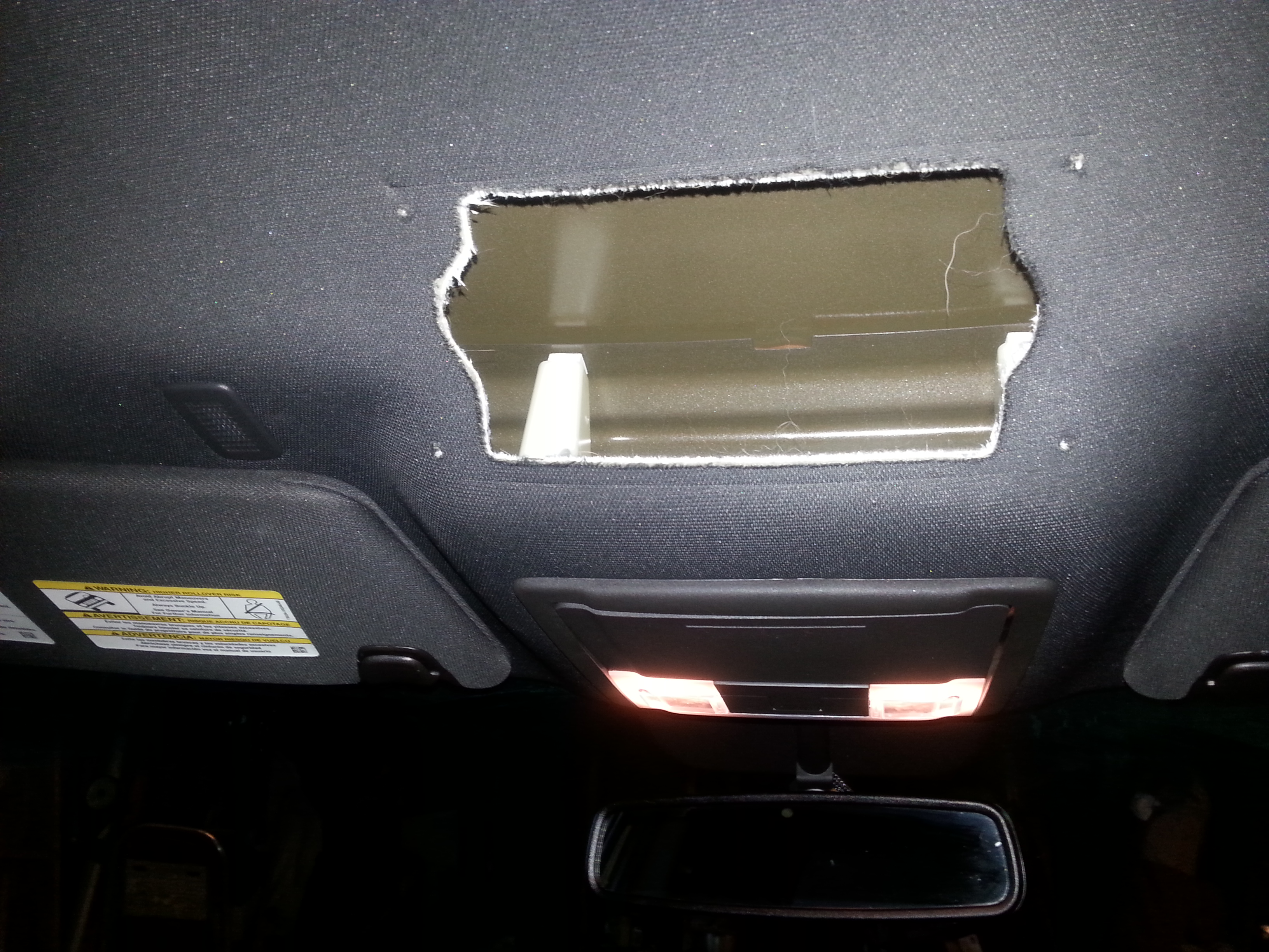

Hi all,
I am looking at possibly buying a 2015 PI Utility with 125k miles. It is in pretty good condition but there is a rectangular hole cut out of the headliner right behind the area where the map lights are. This was a PA state vehicle and it looks like all the Utility vehicles have this same hole cut for a communications radio or something. My question is what could I do to hide this hole? I am thinking possibly putting a little plastic storage slot there, or maybe I could find a similar piece of headliner to cut and fit in that spot. I just think leaving that hole there is kind of ugly. Any thoughts?

Mine came out of PA as well with hole that looked like this

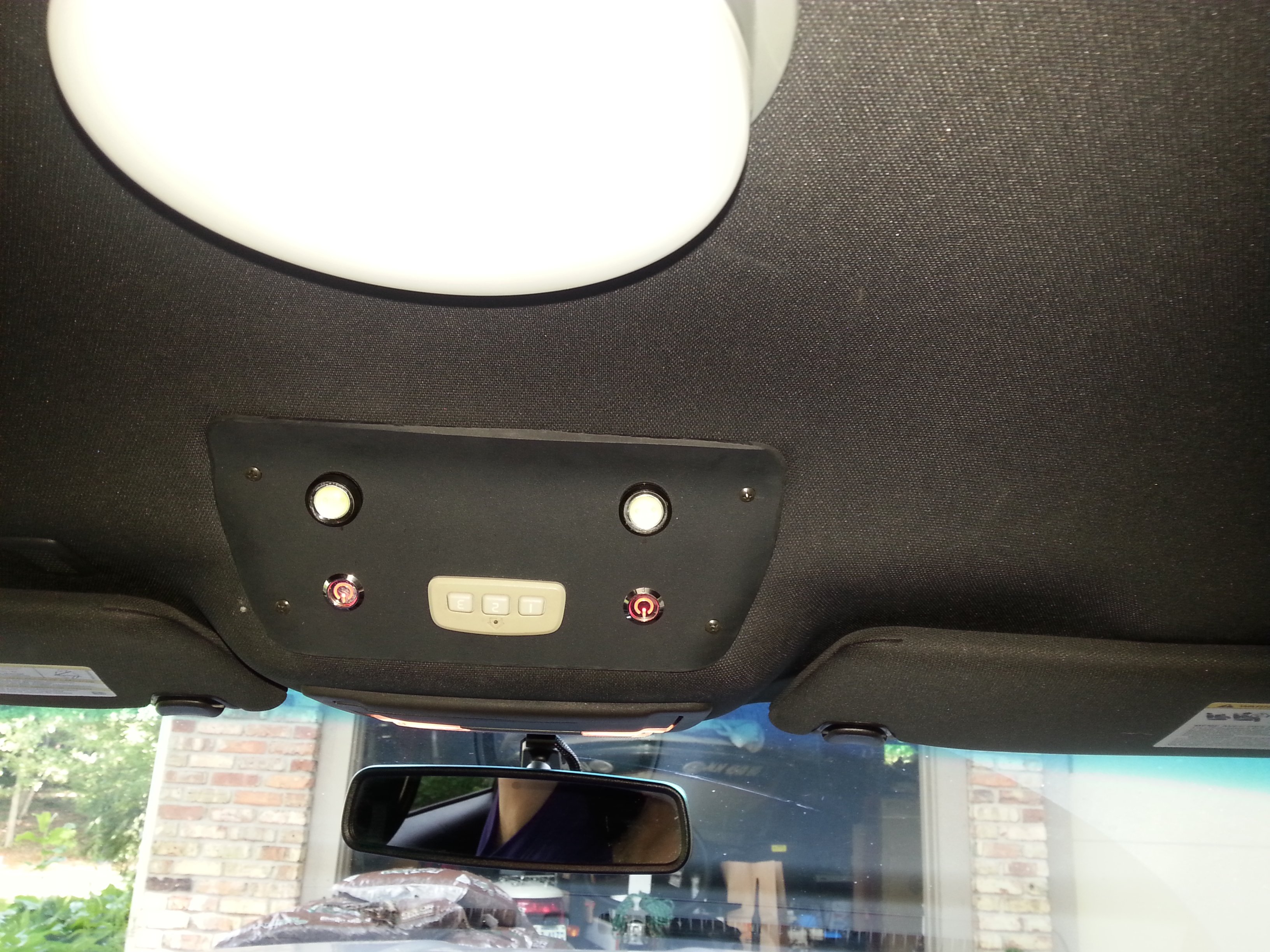

I took that hole and made a plastic insert into which I mounted a Homelink and some reading lights. Not perfect, but functional. The plastic sheet when heated in boiling water was pretty easy to shape to fit contours of overhead. Power came from the overhead light, so it is timer controlled.

I just purchased a 2015 PIU, ex PA State Unit. It has the hole as well, confirmed by others above in the PSP units. This hole is from a light control used with he emergency lighting. I looked into a heavily damaged unit that was at the same auction and it was so wrecked, they did not remove anything. The controller was still up there. Wish I would have taken a better look what the make and model was. I'll try and look around online and see if I can find it.
