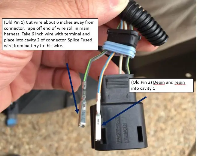

Do you have a junkyard or a way to get OEM HID headlamp assemblies (in Nigeria)? To me this is the best easiest/beneficial method.
See this link and the picture below to complement to thread:
http://www.explorerforum.com/forums...limited-hid-headlights-for-2014-sport.442740/
