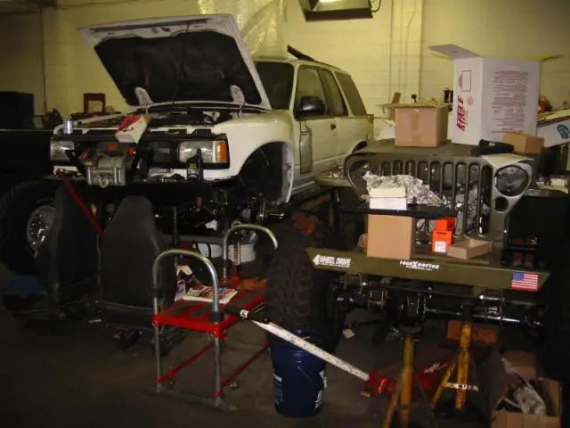

The Navajo is in good company. The rig next to it belongs to the people from Four Wheel Drive magazine. It's thier project heap. I hope the Navajo practices safe off-roading and doesn't catch anything
They might be interested in doing an article on the Navajo.

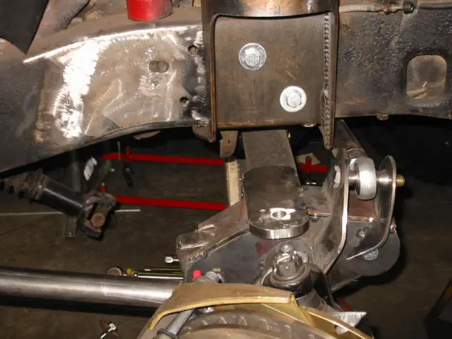

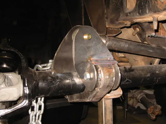

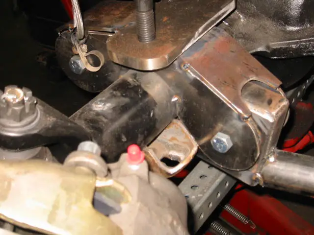

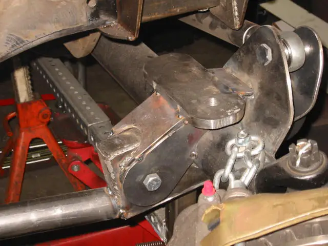

Called the shop yesterday for a progress report. They cycled the suspension with the radius arms mounted and had problems. It seems the suspension is binding and they can't get full droop. I'll be going there on Monday to see what's going on.

Hey Rick, things are going pretty slow right now. 4xDr. is short his main mechanic. The problem we're having now is binding at the radius arm axle bracket were the two johnny joints are. Mike has to take them apart and install different bushings to unbind the axle. But since he's short a mechanic he's not working full time on the navajo.
After we finish the suspension then we try out the Ram assist steering. Hopefully that'll go smoth Right now I'd be happy if I can get my rig back in a month.
