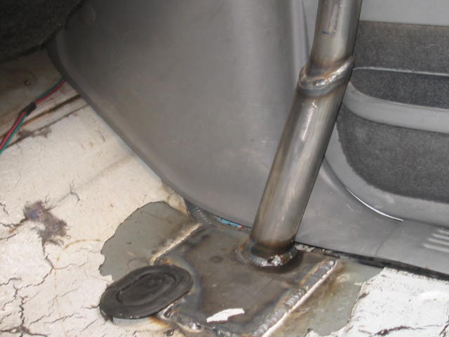

Hey FAKRWEE, can you repost all the info for the place you got it at? Thanks. This guy seems pretty close to me, and I definitely want a rollcage. What was the final price on everything? Looks real nice. Im curious...why didn't you have the cage extended to the back with the roofline instead of having it drop back down?

Mike Duncan is the owner and Dennis the shop Mgr.Final price is $1,600.00. Seems expensive but not really when you figure all the hours they put into it.
I didn't extend it back for 2 reasons:
1-Price. It would of shot the price up more than I was willing to pay. Besides no on is going to sit back there and if I crush the rear it'll just give an excuse to make it a convertible
2-I didn't want the extra weight. I'm trying to keep the Navajo as light as possible. Also I felt that it would throw balance off and make me tippy.

OK, just reread the thread and answered my question about the cage not comin all the way back. Still curious bout the shop and the price though. That tire in there is a 37 right? What kind of suspension do you have in the rear? OK, think thats it. Thanx

37X12.50X17. SOA with Alcan springs with 11 leafs.

Looks like we posted about the same time...Do you know the approximate price difference for extending it back? Thanks man
Ballpark probably around $500.00 or more. Call the Doc and ask him, I don't want to get in trouble with him for over or under pricing
