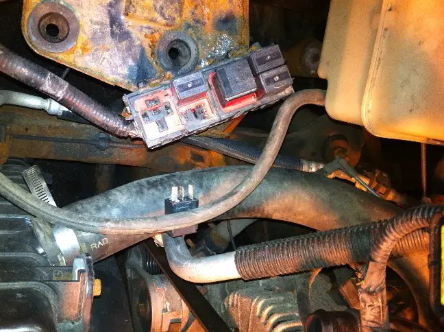

I went out and snapped a few pictures of the two boxes. Sorry for the quality
Box 1 (By the airbox)
I saw R146Rick's post but was somewhat confused. My fogs will only work when the low beams are on, not the running lights or high beams, does this mean that when the smaller square relay spot is empty, this mod will not work for me as well? Can anyone help me out?
Edit: I would like to have the fogs come on with all three. Running/low/high.
What would be the best way to go about this?
Your Photo looks like the Auxiliary Relay Box #1.
The empty small relay slot would have been the Isolation Relay.
Looks like you early build, this mod will not work.
That's what I thought. I also thought about re-wiring them completely separate from everything but the number of wires leading to the fogs is concerning me and looks like it would be a tough project. Would you have any other suggestions?

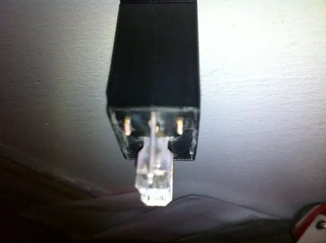

Worked like a charm! Dremelled the side pin off, and put it back in! Literally took under 3 minutes.

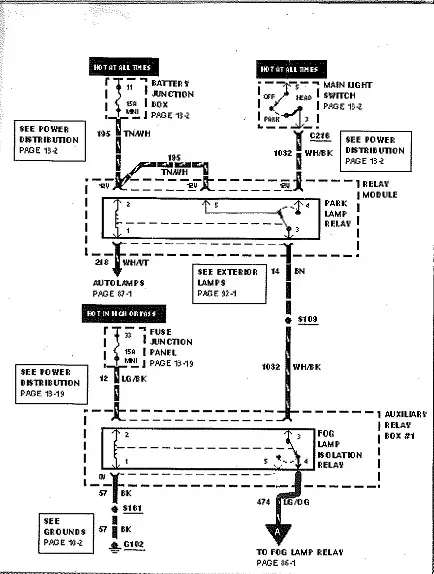

Came across this drawing... might be helpful for someone.

Just did this mod today on my 00 5.0 limited. i followed most of the information on page 2 by clipping the outside prounge on relay number 2 in the auxilary fuse box under the air box. everything works like it should (fogs and high beams):thumbsup::thumbsup:
I was just going to do my own write-up on this! (I should have known I would be late to the party). Here's my contribution:
