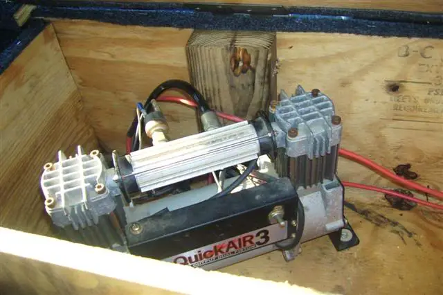

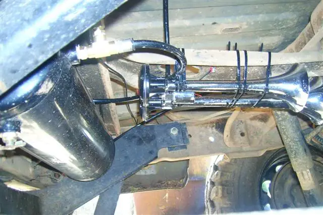

Compressor mounted.
Tank mounted, lines ran, and horn.

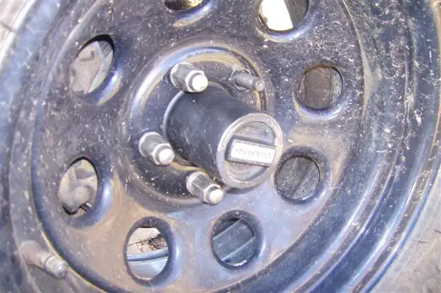

The Jeep Warn hubs.

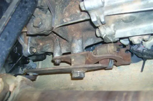

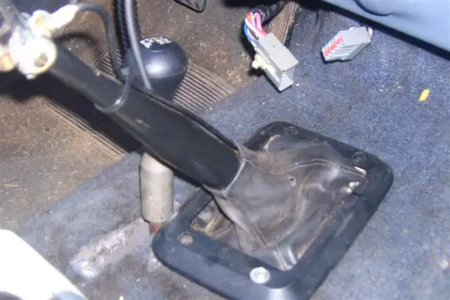

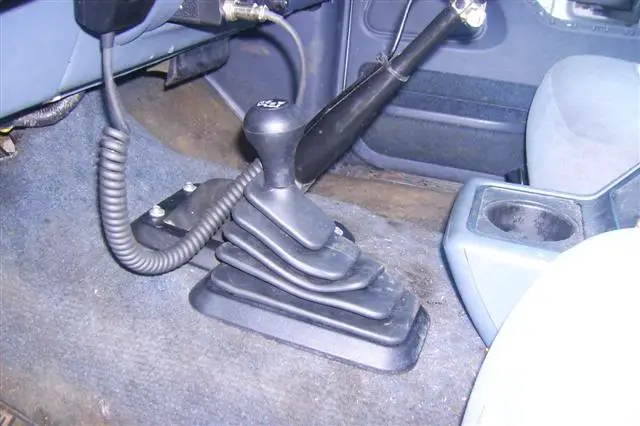

Twin sticks. Still working on it.
Got the shifter problem straightened out. Had to cut up the bezels to get them in. It will work for now until I can find a one piece one.

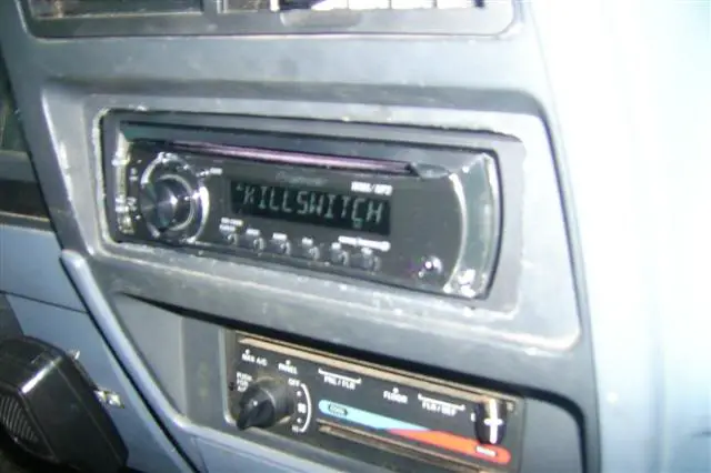

Picked up a new CD player from Best Buy. It was $120 and its ipod ready and came with the cord needed which is why I got it. Sounds good and works great with the ipod controls built in.
Picture sucks

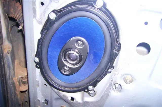

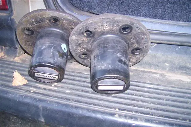

Scored some more parts at the junkyard. Found some brand new looking Pioneer 3 way speakers in a Explorer, found some more amp power wires, and as I wan watching them bring out more cars they brought out a Explorer with manual hubs so I grabbed them and the locknuts. Cool thing is I only paid $33 for it all.
I knew right after I broke down and bought a set for my Explorer I would run across a set at the junkyard. I just bought a set 2 weeks ago and now I found these. lol
Speakers

Hubs

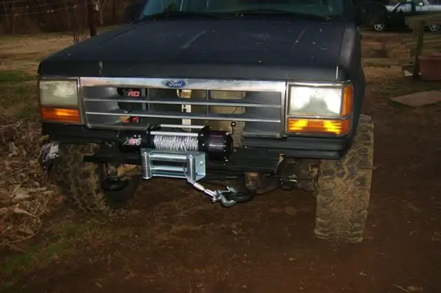

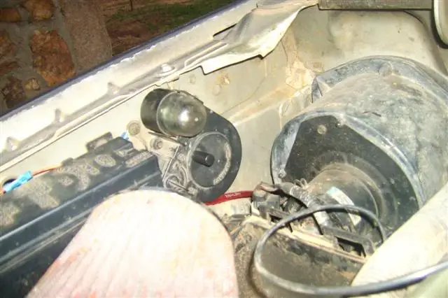

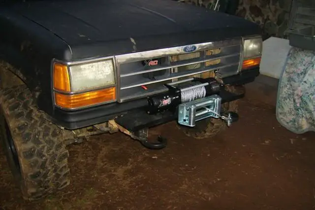

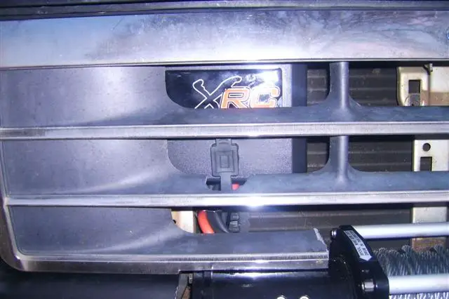

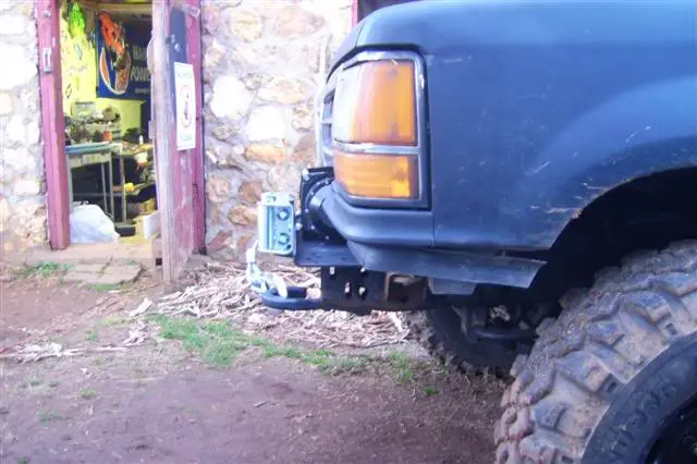

Got the winch mounted. Used a universal winch plate for now. When I go to make a Bumper for it I will probably just go off of it. I mounted the control box behind the grill.
Control box.

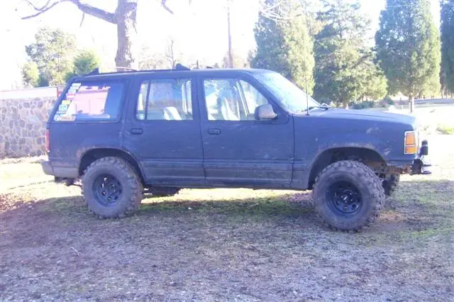

Side profile shot.

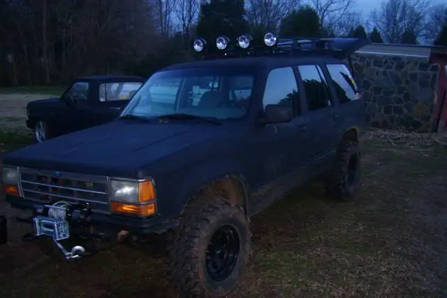

Just went and picked up a Surco roof rack I found on craigslist for a good deal. Also bought 4 6" lights off ebay the other day to put on the rack. Won another set of Pioneer speakers like are in the front doors to put in the back.

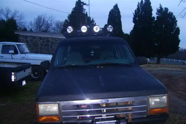

Got the rack painted and on, lights on, and a new Firestik CB antenna. Now I just need some new coax cable to hook the antenna up. Also have 2 more smaller square lights to go on the back of the rack for reverse lights.

the truck sure is getting there, how do you like the manual t-case compared to waiting for the electric one to shift?
Put the manual t case in so I would know when I put I in 4wd it's actually in 4wd and I don't have to worry about all the electronic stuff quitting when I actually need it.

Im thinking about getting a roof rack similar to yours and putting the exact same lights on top, but my question to you is how did you go about running the wires for the lights? I want to avoid drilling and running anything in the body (hopefully until my X is in my name, still in my moms)
Thanks.
I dont much care to drill a hole in my rook either. I just ran the wire from under the hood up the outside of the a pillar door seal deal and it come out and goes up to the rack and I have it zip tied out of the way and all. Dont really notice it unless you look for it.

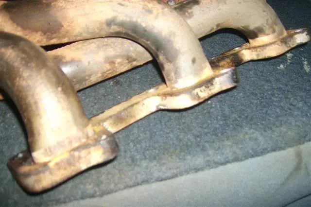

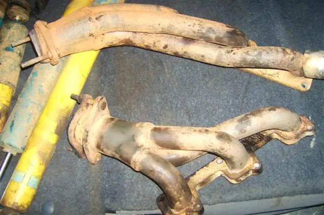

Scored a set of headers from the junkyard today. Got them for $16 and some change. I believe they are Borla. The Explorer had a Borla Exhaust sticker and thats what they look like to me looking at pics on the net but Im not 100% sure.
Also picked up a set of Bilstein shocks. Not sure how good of shape they are in or how many miles for for $5 each I said why not.
Got some questions on the headers. What brand do they look like to everybody and will they work with a stock y pipe or will I have to get one/make one? The y pipe that was with them was all tore up and cracked but it looked like a stock one to me but Im not 100% sure.

When it snowed last week and I was pull people out of ditches I lost the remote for the winch somewhere so I want and bought another one and then the next day I found it but it had been ran over. Switch and everything still worked so I used the switch and wire to have a control in the cab.
