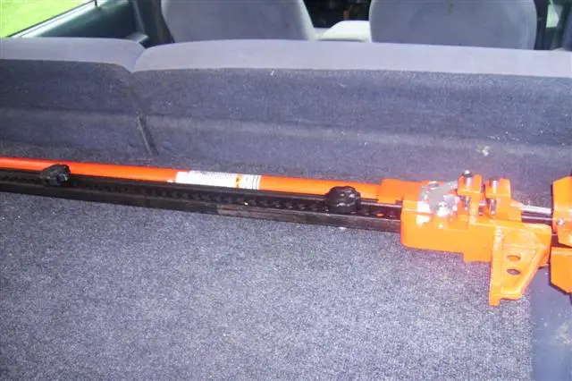

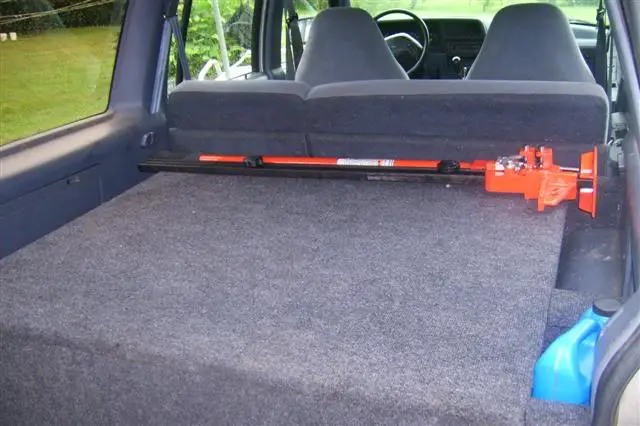

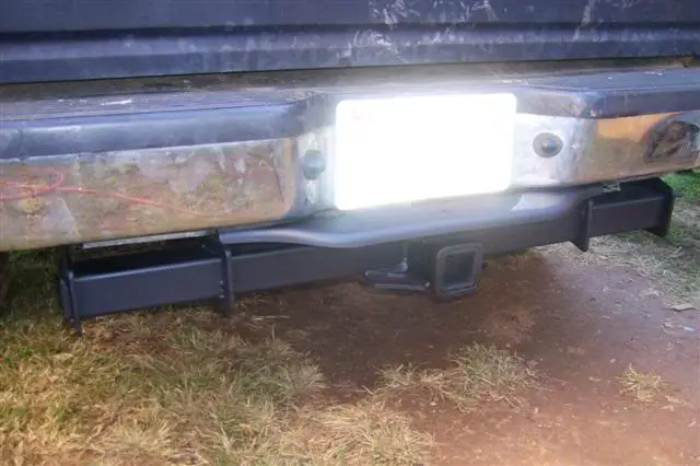

Got a trailer hitch receiver at the junkyard today and picked up a 48" farm jack at Harbor Freight for $40. Got the hitch mounted earlier and Im going to mount the farm jack on top of the storage box in the back. Ill probably do that tomrrow so Ill have a few more pics tomorrow.

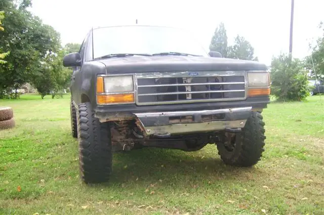

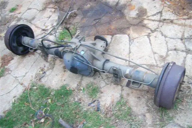

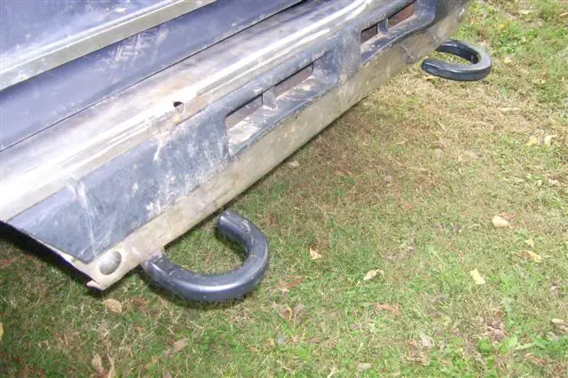

went to the junkyard and got some tow hooks, a 3.73 limited slip rearend and got a front 3.73 center section from my buddy. We did a Lincoln Locker in the front so we will see how that goes.
Also chopped the bumper up since it was already bent all to hell. Im going to get a straight bumper but im not sure if Im going to cut it like this one or not. Not sure if I like it or not.
Rear end
Tow hooks
Front Bumper
Changed the gear oil and put new axle seals in new the rear end today.
Got the old rear end out and the new one is ready to go in. Im going to try to get it in and get the front swapped out tomorrow also. Hopefully I can get it all done.
Well got it all done today. Got the new rear end in and swapped out the front center section. Went pretty smoothly just a pain trying to get the front diff and traction beam lined up and the passenger axle splined all at the same time by your self. Took 2 jack and a jack stand to do it but I got it in.

looks great, i need to build a storage compartment...great idea

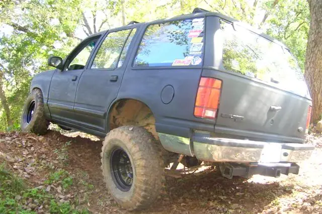

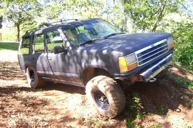

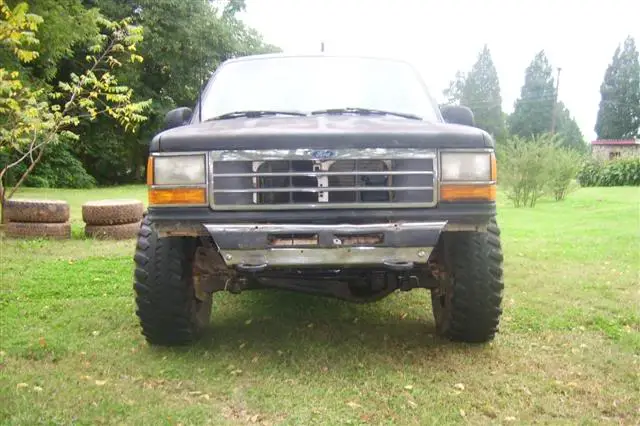

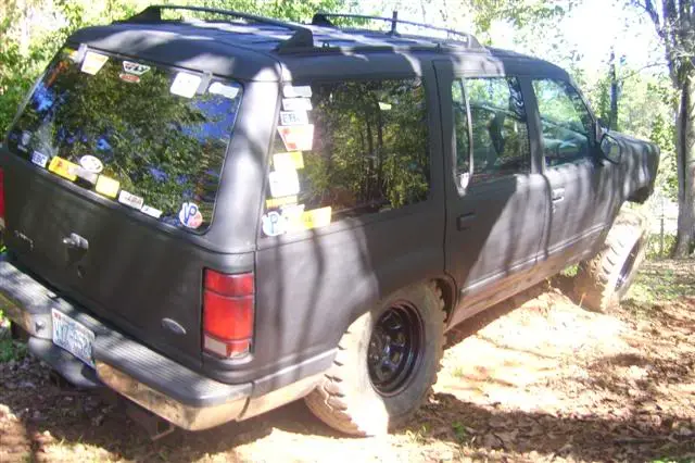

Got the oil changed today and degreased/pressure washed under the hood to get all the gummed up grease of everything since i got all the leaks finally under control for the most part now.
Also re spray bombed it. Ill get a few pics tomorrow.
Here are a few pics of the new spray bomb job and a little flex.
When I was taking these pics I noticed the gap in the front bumper was all messed up and took a closer look and the washer for the core support mount is gone or its rusted out.
