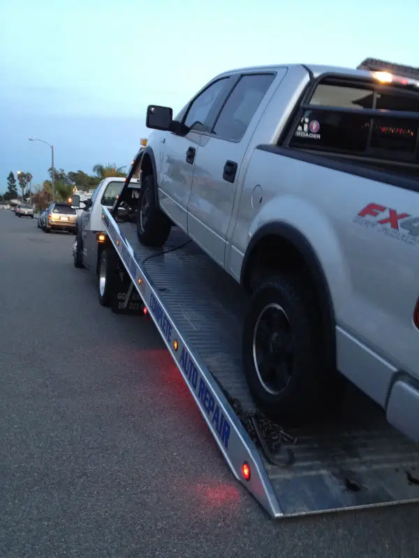

I'm starting to believe that whole, "Don't flush your high mileage transmission fluid, just replace the filter and fluid." stuff. Trans went out Saturday night...
Thankfully my dad has an extra vehicle that I can use until mine gets fixed.

I got a call from the shop after they did their diagnosis and they said it needs a full rebuild, which I figured. The guy said the 4RW75E are usually an 80k unit... Options are they rebuild it with a 12mo 12k miles warranty or they get a factory unit which has a 3 year unlimited mile warranty. The factory unit is about $3500... I said F that noise and they are going to rebuild it for me for $2200 out the door.
I'm at 74k+ right now, so I guess I have some time:(
