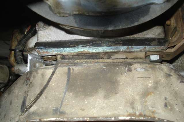

That's interesting if the CV joints are strong enough.
Mine not yet used, is also a DC front shaft I had made. I've looked at the front angles many times and wondered if the TC output shaft is parallel with the front pinion shaft. The angle of the two shaft is the biggest key for eliminating drive shaft vibrations. I would first try to adjust those to be parallel. The front diff, those all have three bushings in their mounts, and at this age many of them are wearing out. I think my rear one in the bracket is worn on my 98, I ordered four of the front ones, those are identical. The rear only comes with the bracket, which is a too much $190 price.
The trans mount on the cross member is a weak link with the BW4406 installed, that may be a big source of change of the output shaft angle.
Don, I am pretty sure the 3 bushings are the same, but pressing the old one out and new one into the bracket is difficult.
try prying the mount with a bar. If that rear mount ( torque bracket) moves away from the frame at all, the bushing is worn. This was the issue causing my transfer case to pop into neutral when stressed in 4wd.
I tried 3 different front diffs, and even another transfer case to fix it. The mistake was using the same torque bracket on the trial diffs. Once I changed that, 4wd works well.
