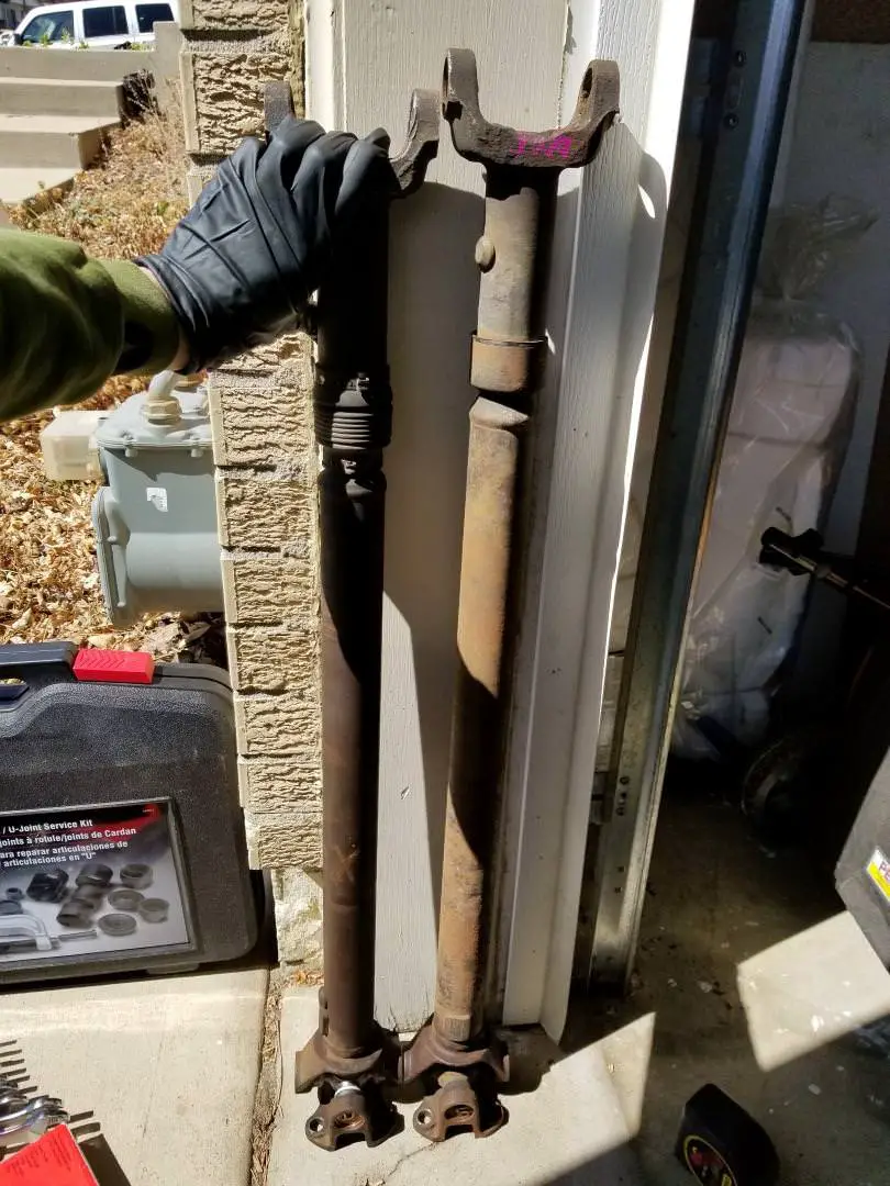

My front driveshaft findings: the 97 and 98 4.6 F150/Expedition front driveshaft is about an inch longer than the 99-03 front driveshaft when fully compressed. Figured it out after crawling under half a dozen of these at the junkyard. I also noticed the later model driveshaft has a boot/bellows seal which covers the slip shaft, while the earlier model has an integral dust seal that rides on the exposed slip shaft, so I guess that is another way you could identify the two different shafts. I came home with a driveshaft from a 99 Expedition on this trip, and I was able to get in installed on my explorer, but even this shorter shaft would just barely squeeze in there.

98GreenLimited, you have discovered the very same thing I did. I personally think the biggest reason we are have having issues is just what you pointed out, the 4406 front output shaft is at least 1" closer to the left side frame rail causing the angles in the horizontal plane to be greater. I have personally tried both the stock 91-96 front drive shaft with the flange conversion and the F150 single u-joint drive shaft you just tried. In my experience the F150 drive shaft is far worse than the double carden drive shaft.
I am still running the stock 96 double carden front drive shaft with the conversion flange, but I still get a vibration that starts to become noticeable between 65 and 70mph, and then increases with speed. I think the only true solution to eliminate the high speed vibration is to go with a true CV style joint (ball and socket) at the transfer case and the front diff like the newer F150's have. Even all of the newer mustangs have CV style joints at both ends of the rear driveshaft. The issue with this is obviously finding someone to make a special shaft like that. From my research, the front yoke and the adaptor at the transfer case would have to be custom machined.
