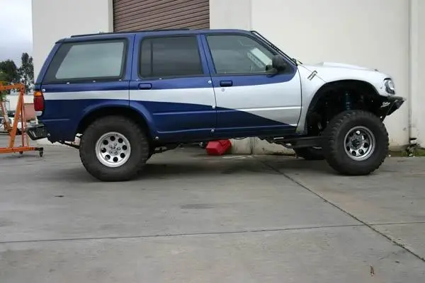

Maybe i'm missing something, but why would you extend the radius arms 2"? Can you do that without moving the beams forward and extending the driveshaft?

well i gave some thought, and now im thinking about cutting off the "tabs" of my radius arms and welding some new ones on, at the same time spacing it so that i would lengthen tha arms a bit to move the front wheels forward maybe 2"s
the arms are just stock extended so i want to just weld plates on top of them and it would make up the 1/8" difference from the plating on the beams. do you get what im trying to say?
All the high end ones I have seen all have rounded edges or tapered edges.
I advise against the adding length to the rad arm ears. The MOST you can push the axle forward would be 1" I've done this to mine. On full compression the passenger side axle shaft is about 1/4" from the head of the pivot bolt. Keep an eye out for that. I had to reverse the bolt direction from factory to get more clearance. The bolt head was shallower than the nut.

copykat, i looked at that when i had drop brackets and noticed that the axle clearance was pretty close. but with stock pivot brackets and it should clear no prob. i know the racer guys push their axles forward like 7"s. im just gonna check how much drive shaft i have and see if i have enough to push the wheels forward or not. the idea i have in my head should work fine and be plenty strong on the radius arms, but it'll be kinda funny that they're stock in hte middle and and custom on the ends.
i want to extend the radius arms to move the beams forward. do i have enough drive shaft? i don't know

Are you doing this to get the front wheels out of the back of the fenderwell? I can see getting 1-2" forward and I agree this would help. 7" though? How does that manage to still pivot without binding up at the axle pivot?

why so much as 7"s? don't know. but yes i want to keep the wheels out of the firewall. when i was looking at built trucks in the McNeil shop, the wheels were waaaaaaaay far forward! i guess its to keep the wheels from hitting things and give a little more wheelbase for stability???? i actually have my wheels pushed forward about an inch, but i still want them farther forward, i hate the look of them reall cloe to the back fender well.

How are the guys pushing them forward 7 plus? Are they moving all the brackets?

well i was told that they move them up 7" but maybe only on the 2wd
but they move em forward
