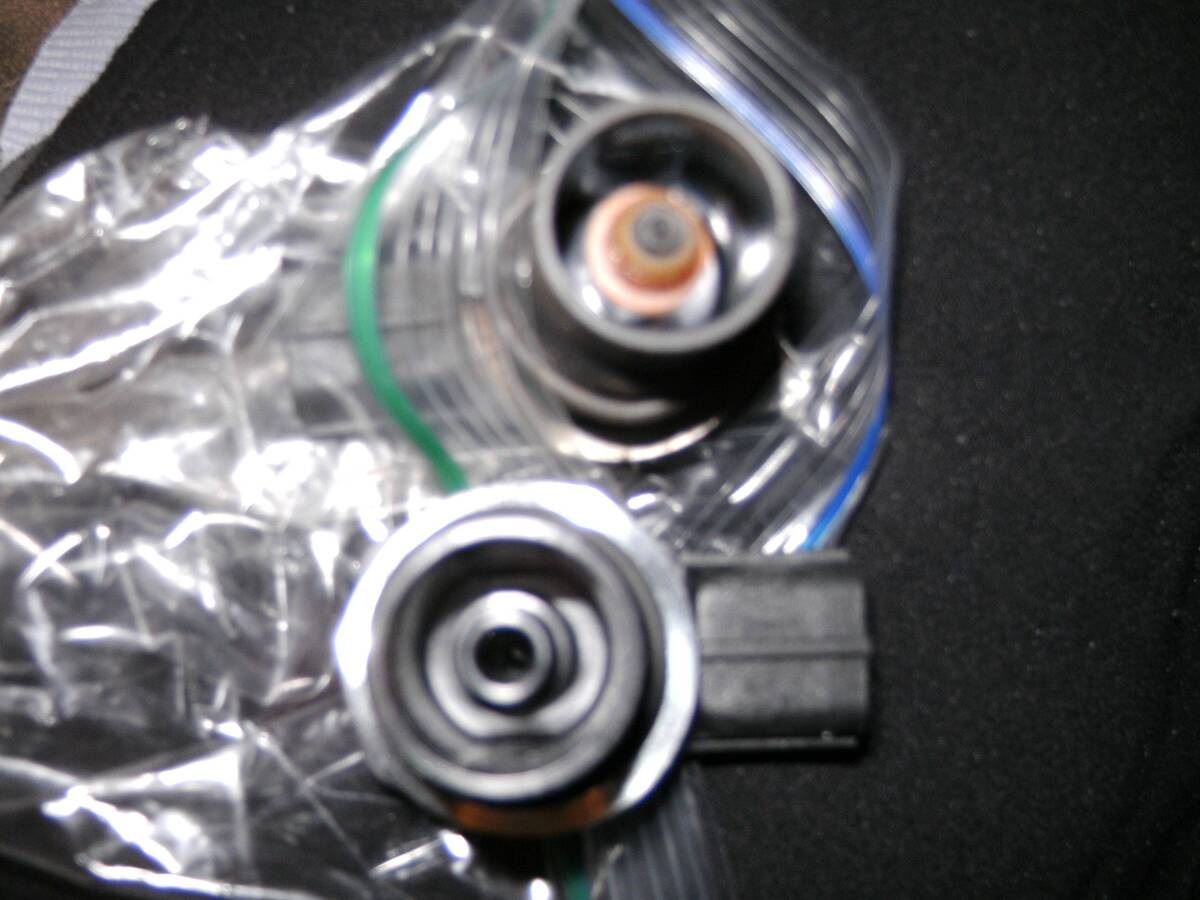

Now the part Rockauto sent me don't look like the stock one. The fuel vapor pressure regulator or whatever its called that twists on to the tank itself, if you look inside the stock one it has some orange piece, the new one I finally just got delivered from rock auto doesn't have the orange piece in it. Does anyone know anything about this?
How do I post pics from my phone? I'm on a Samsung Galaxy S3 or S4
I managed to get a digital camera since no one can tell me how to use a expensive cell phone to upload pics here. The orange one is the stock part, the other part is new part from rockauto http://www.rockauto.com/catalog/moreinfo.php?pk=940533&cc=1354553
Just a guess, could that be the rollover spill protection valve?
Bill
Fuel Tank Pressure Sensor that twists into the fuel tank.
I contacted rockauto and they said send a pic to service@rockauto.com which I did of that pic shown and of course no response back. So calling them back tomorrow.
Yup it was missing that piece. So rockauto now decided they have to send me a return thing to put on box to return part which will take about a week, to get here, then when they get the part they will send me new one. So I have to wait about or atleast 2weeks to get new one even though I demanded them to send me new one overnight or atleast 2days.
