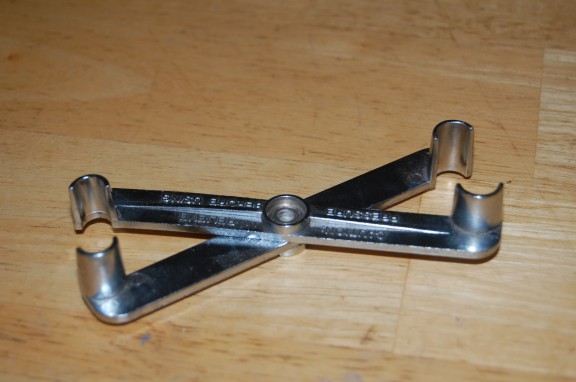

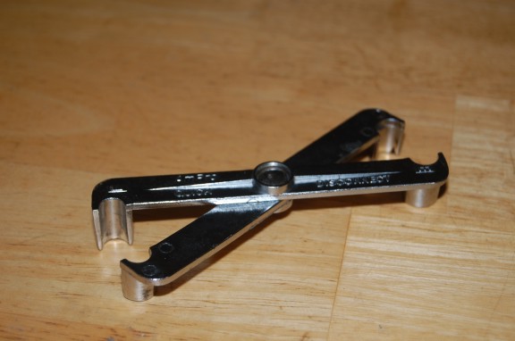

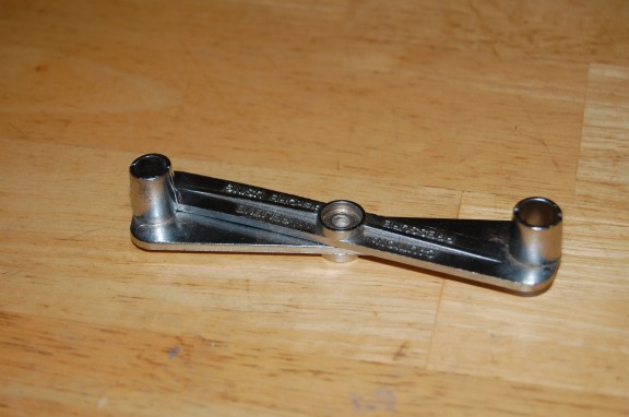

I use a metal tool and it workd great; never had a problem with it.

Where did you get that Al???

Will try the plastic tools, have the metal one shown above. Doesn't work at all. Seems like the leading edge may be too big or something. Fingers wont slip over it I guess.
I've had luck with both the plastic and metal ones but never both.. If I can't get it with the plastic ones I switch to the metal ones as I seem have have better luck with the plastic ones... but sometimes the metal one works better..
