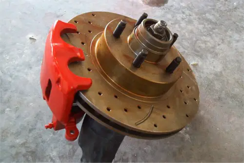

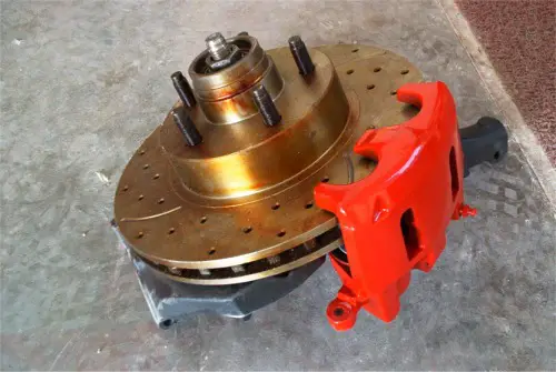

Check it out, smoothed out calipers painted red. Not sure if I like the red, I may paint them gray instead.
How did you smooth out the calipers?
I just used a flapwheel on my grinder. Cleaned them up pretty fast.
Nice, I gotta replace all that garbage soon too.
That looks awesome
