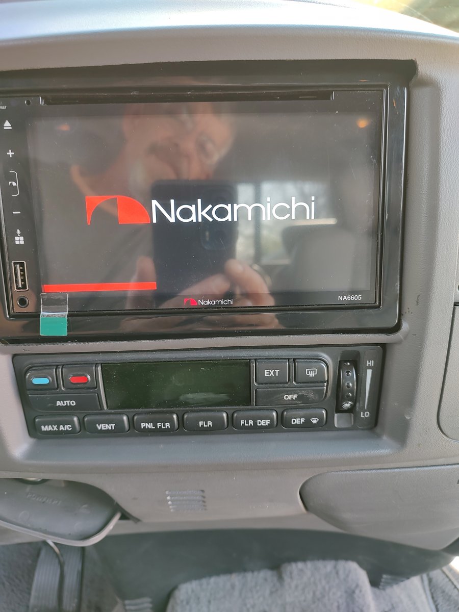

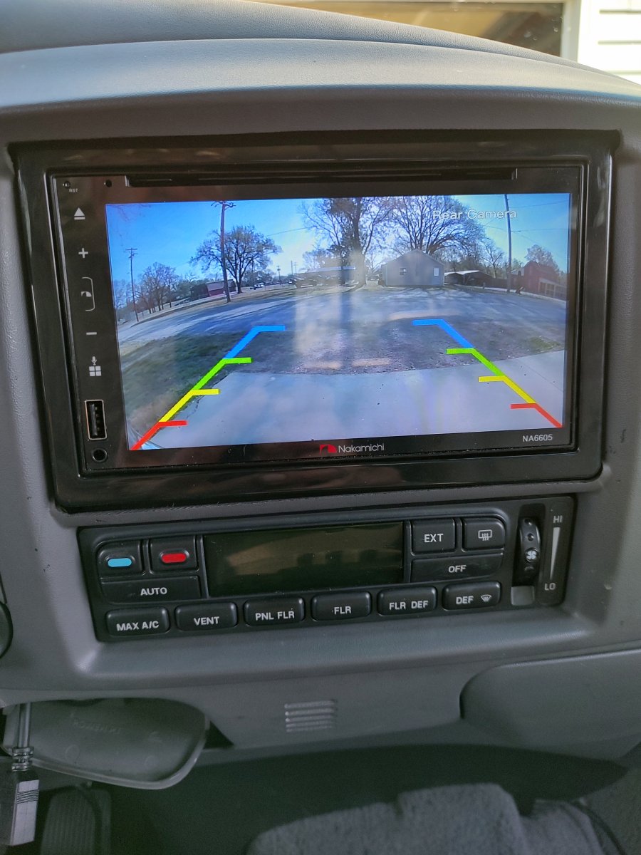

Here it is in our 2003 f150, backup camera installed.
I did not discount the atato suggestion, but did get 2 of these , and a camera for pickup, for less $ than one Atoto hu alone.

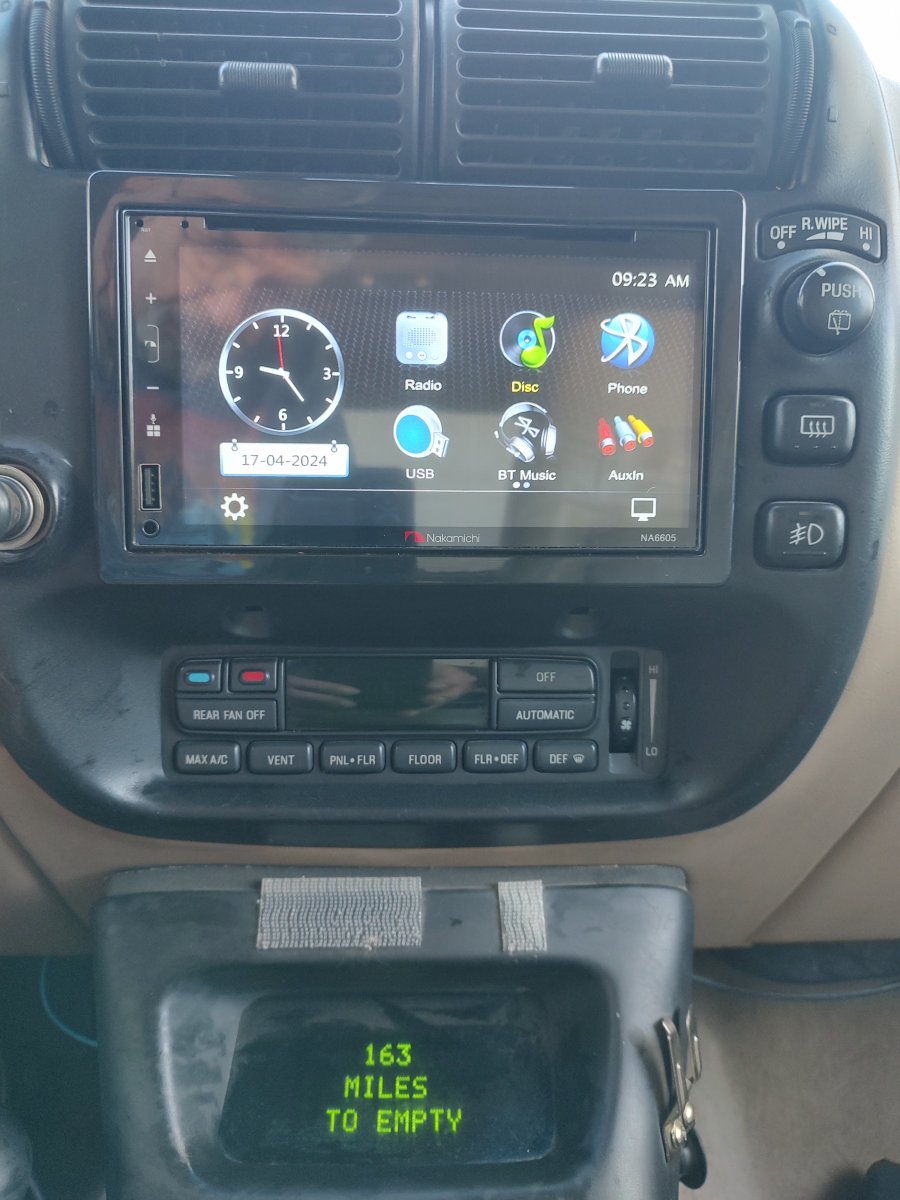

Here it is installed in dirty girl. 2000 mountaineer
I suggest a double din frame kit of some type. Bezel needs cut back to roll in, top and bottom. I used 2 layers of vhb tape to secure metal mount sleeve to remaining bezel frame. Your results may vary

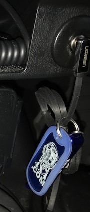

Okay, got an "old guy" question . . . This would be a cool upgrade for my 2011 Ranger - - like the idea of a back-up camera in that rig.
So, for you audiophiles and wiring savants, is there anyway to wire in one of these units that will still allow the use of this accessory outlet?
. . . for my iPod. . . Don't need the CD player - - , but in my defense, at least my preferred music source is from this century, but still want to use it. . .
