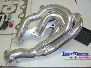

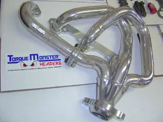

Here's Torque Monster Headers, 4 tubes into one collector, plus added technologies:
l

I have held both in my hands. There is no comparison. I can say it without naming brands, and you know which to get.
I might add, you want to get rid of those stock manifolds.
The #3 port is so small, my finger won't pass thru
Gee Robert, you even show a coated set of FMS to give them a better appearance, and they look like crap compared to the Torquemonsters
you should see what you'd really get with the FMS, it aint pretty
They aren't coated and will rust in a year
