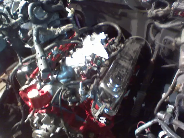

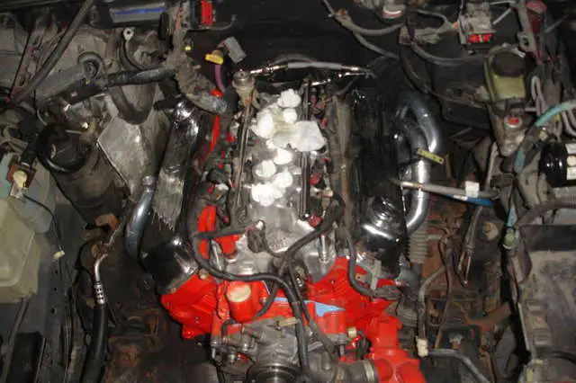

Here is the final pics of the engine before I put the hood back on.
hows your engine vacuum with your cam and under a full pressure panic stop on dry roads to a COMPLETE stop? I didnt like the way mine felt (mine is differently setup though) and adding a vacuum pump teed in the the booster line worked and now the brakes are touchier than stock :confused:
It's not bad at all. I'm running 31" Baja Claws so braking wasn't as good as stock to begin with. I did away with the EGR so there is a slight bit of extra vacuum power there.
The next step in my plan is to upgrade to 02-05 Sport/Sport trac 12.8" front brakes and knuckles, maybe slotted rotors if the price is right. I may replace the master cylinder at that time too since the stocker is now about 12 years old.
